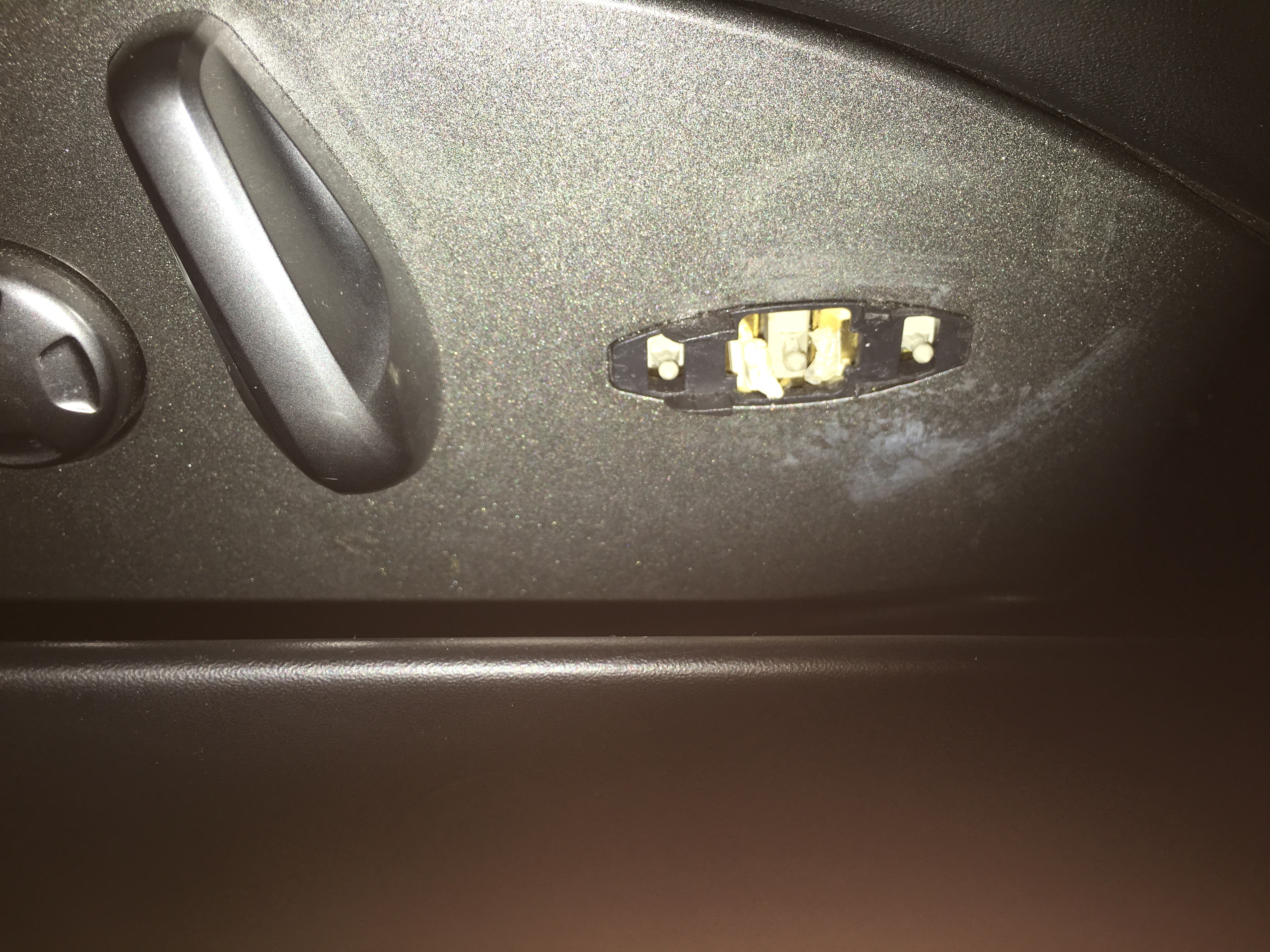

Is this what you broke? If so, then it will be $500+ parts alone. My son broke the button 4 years ago and I still haven’t fix it because it is a $1000 job at the dealer. The white piece is part of the motor assembly and needs to replace as a whole. The motor is at least $450 last time I check, and need the 2 switches because the old switches won’t work with the revised new motor. It can be DIY job but required seat removal, shut down airbag and disassemble of the seat. I really hope this is not your case because it will be costly.

thank you John sadly that is my proplem I was hoping that I was going to be able to buy and change just the white peice inside but I see it’s not possible

Dealer and I tried the glue and sadly no luck.

Rather than some kind of glue or super-glue, did you try a marine epoxy? That's the one that has two tubes (glue and catalyst), hardens almost like steel and can be molded or milled if needed.
Just a thought...
