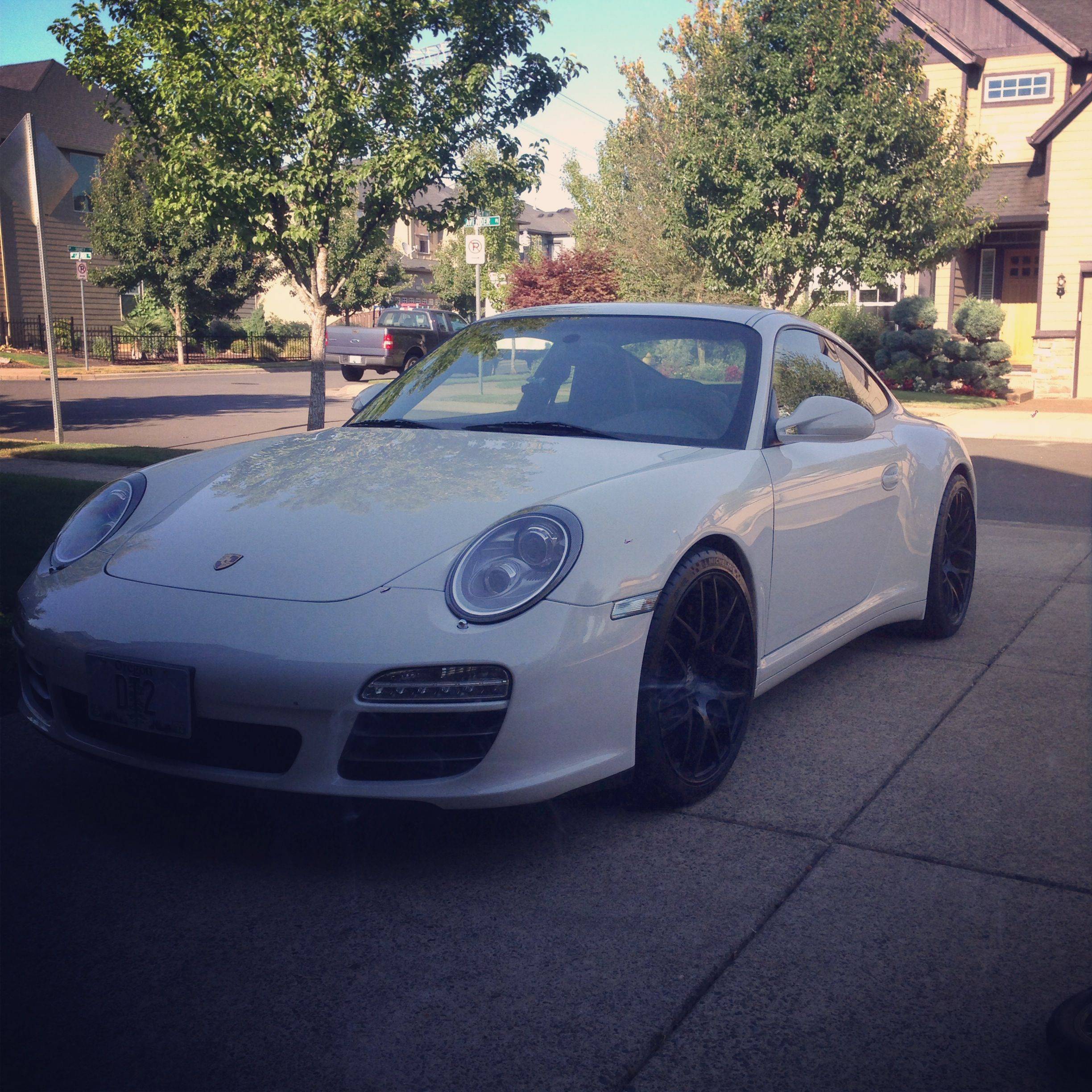

I have the Rugers and love em. I've had them going on two year now without any issues.
Pick of them on my 09 c4s

Thanks Dang503... Did you have any issues with the 17mm splined wheel bolts? Not sure why A/G uses the tuner bolts VS the factory stuff. I was told the counter bores for the spline bolts have close clearance and can damage the finish if your not careful. Also, do the OE center caps fit the A/G Ruger? The 09 C4S sets perfect, your offset and height is just rite. What springs did you use? Thanks for your feedback.

Roadent,
No issues. Not sure what size the lugs where but the shop I ordered from sent matte black ones with my wheels. They fit fine, no issues. Haven't had any damage to my wheels, and had to have them removed/put back on multiple times due to a bad TPMS (and also a recent nail in the tire...)
The tires came with the center caps as well. OEM center caps wont fit.
I have no after market springs, just a C4S and that's how it sits.
The wheels were staggered:
19x8 5x130 +45 71.6
19x11 5x130 +40 71.6
Hope that helps.

Dang503,
Thanks for the feedback... My main concern was the spline wheel bolts VS the factory style. This doesent sound like an issue. The A/G Ruger 19" wheels look great and have perfect offset. How would they fit if a set of Techart springs were installed?? Would you have proper tire clearance. I am also looking to lower the ride height by about an inch.

If it rubbed, very slight camber and a fender roll (the inside lip that you can't see… it's done all the time). You'd be fine.

I don't have much room on my wheels between fender and tire. Car's in shop right now but when I get it back (thursday or friday) i'll take a pic.
Basically, I can barely fit my key in the gap if I slide it in sideways.
Question back at ya, what model are you throwing these on? I have a C4S with sports chrono. I believe it's 10mm lower then C4S w/out chrono?
