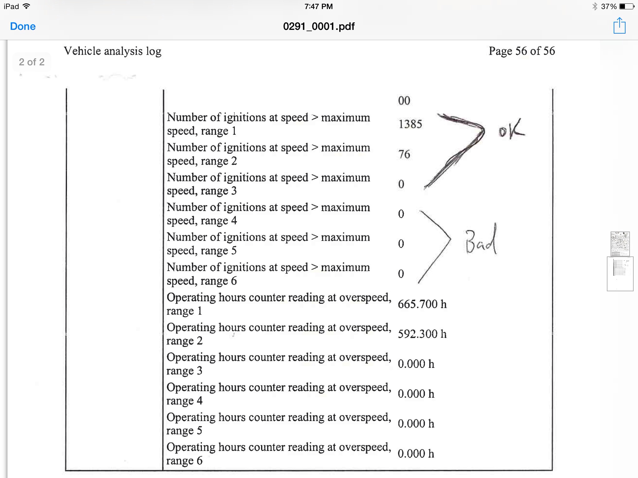

DME Report
Here's the DME report which turned out excellent!

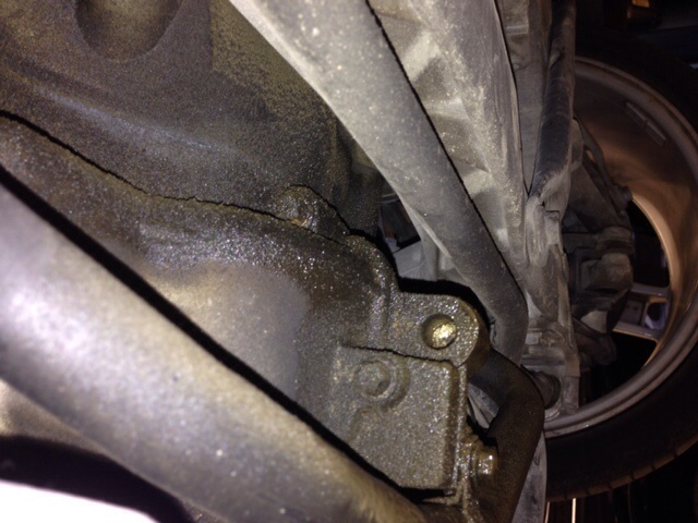

Here's a photo of the RMS area with findings. Technician took this photo showing some signs of the oil seepage not "leaking" coming from the rear main seal area.

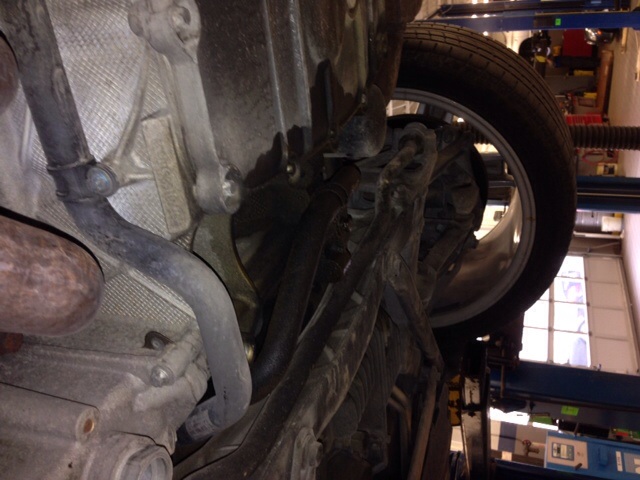

Photo # 2
Here's another photo of the RMS area with findings.

don t like the oil leak. RMS.?
don t like "no service history". it may need plugs ($700 job unless you can DIY, but it in t easy).
Front and rear spoiler painted... plus possible damaged wheels repaired. Maybe an accident car.
Tires coming up very soon.
I think you can do better as far as condition of cars. Now I don t know about price and mileage so....
