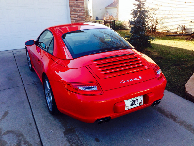

997.2 and 997.1 tail lights and fog lights are not the same, subtle differences will force you to change the whole bumper, I recommend getting 997.1 led lights, to answer your question about the resistor if you get the 997.1 led's they are plug and play, just replace your existing tail light with the one you buy, I did just that....

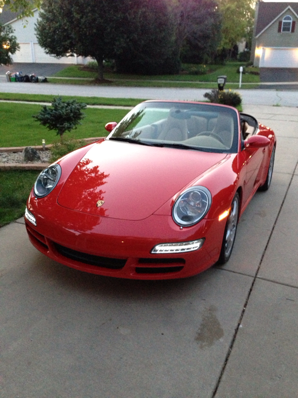

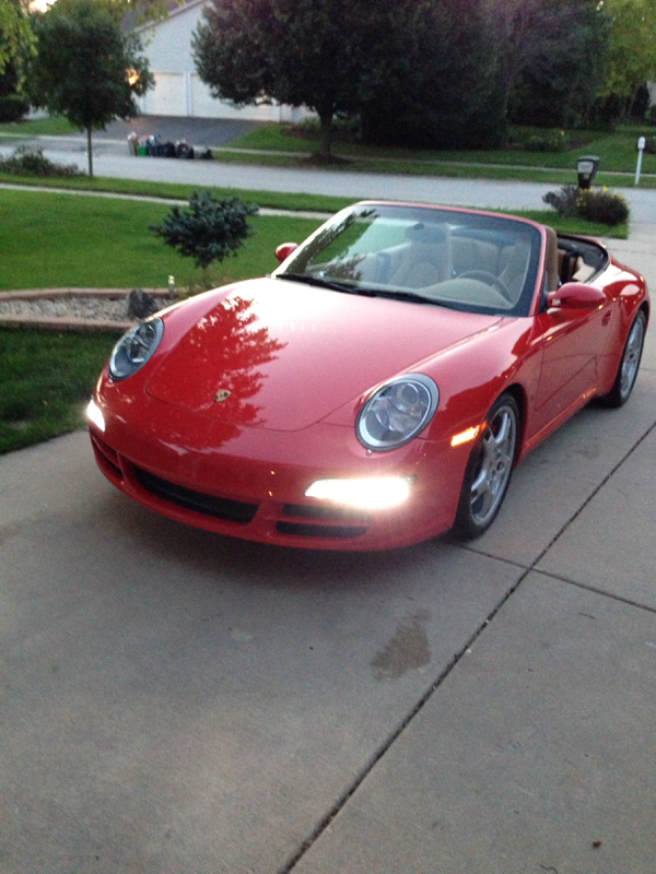

To have the front fogs work as DRLs you will not to do a little hack, the easiest way is with a diode in the switch. Leave the switch the Home position and the front fogs will come on with the ignition. If you want them off for some reason just turn the switch to Off. With headlights on they work just like the fogs, ie: pull the switch out one stop.

Phil, I didn't understand how to run the fogs as DRL, can you run it by me again as if you were talking to a 2 year old, I keep having to turn my fog lamps on manually every time to get the DRL look..... Bit of a pain since all the other lights come on but the headlamps .....

Some people have just done it with a piece of wire acting as a jumper, but quite a few people reported battery drain, so a diode works best and does not cause any issues.
I found the info on how to do it here on 6Speed and here's the pictures which explain it all:
https://www.6speedonline.com/forums/...lights-14.html
I found I didn't need to use any black tape. I just trimmed the diode legs a little shorter, so the diode fitted neatly inside the connector cover and then put the cover back on and used a small zip tie.
Once you have the switch removed, put some blue painters tape around the surround on the dash so you don't scratch it while working.
There are some instructions here on how to remove the switch, actually took me a few attempts to get it right:
http://www.macarbon.com/install_guid...structions.pdf
This is the diode you need, which you can pick up at RadioShack:
http://www.radioshack.com/product/in...uctId=2036268#
Once completed when the switch is in the Home position the fogs will be on all the time as DRLs. In all other switch positions the fogs will work as they normally do. I leave the switch in the Home position as I like the added safety of people being able to see me easier.
