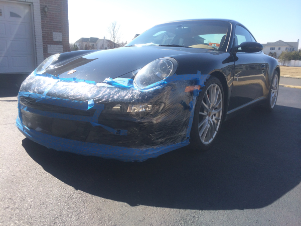

For your amusement, here's a picture of how I drove the car home covered in "seran wrap" !!...
Name:	Saran Wraped Porsche.jpg
