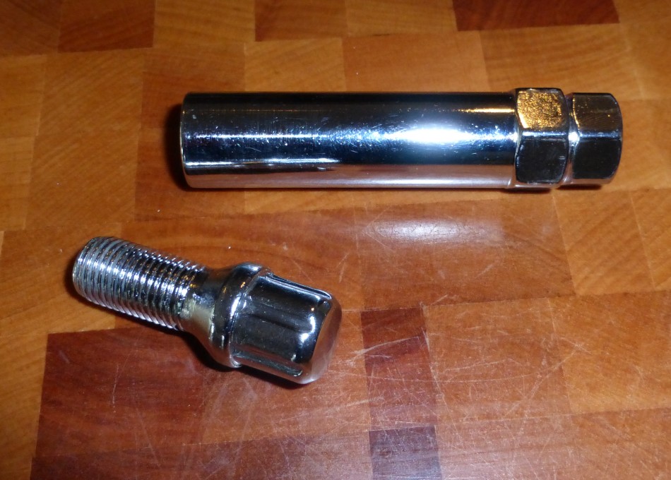

My AG rims use tuner lug bolts, do not use stock or aftermarket spherical bolts on any rim with tapered seats.
The hole size for the lug bolt is very small on my AG rims, and you need to use the AG splined lug bolts. They are around $100 a set and available from a few places online.
Make sure you know exactly what type of lug bolts you need and get the correct ones.

If these are the ones you need, I have a set here. $70 shipped. But to be honest the rims should have some with a set of lug bolts and I would call the vendor and ask for them.

Phil_D, thanks for the info and offer I'll wait to hear back from vendor and see if he'll include the set with the wheels so I don't have to dish out more $$. Meanwhile can you please tell me the messurements on this bolts?

They are M14x1.5x25. I'm pretty certain that AG supply a complete set with the splined socket with every set of rims.
