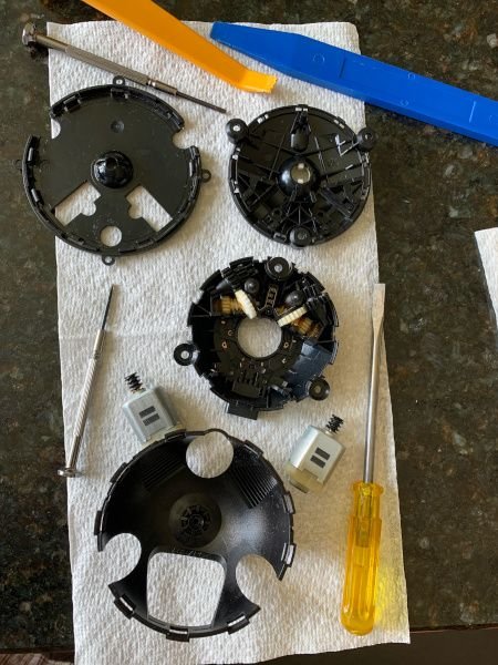

It is probably the mirror motor assembly.
The part number for the passenger right side mirror is 997-624-048-01, and I was able to order it from Gaudin Porsche Parts for around $130.
Here is what the assembly looks like inside.
I DO NOT recommend taking it apart to replace the individual damaged motor; it is VERY difficult to do without damaging the assembly and plastic locking clips.
I verified that only one motor in this assembly was bad by switching their positions and reinstalling the assembly in the car. You can see these are just standard DC motors, so it's expected they would fail eventually when exposed to the environment (temperature, dust particles, water, humidity, etc.).
