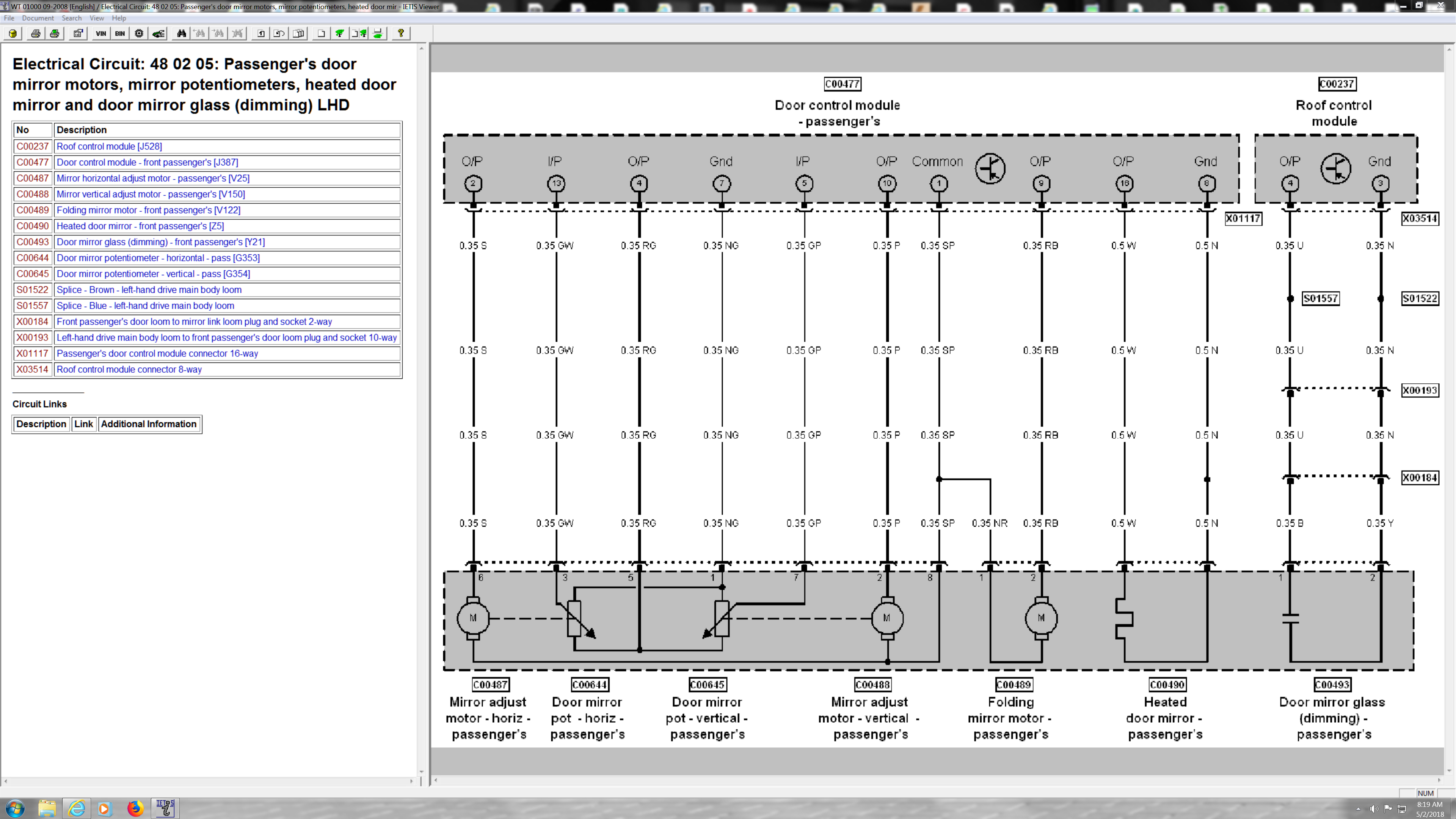

Hello Zissis,
Does the passenger side mirror adjustment work in all four directions, or are all functions dead for the passenger side ?
Passenger's mirror adjustments work perfectly. Even the auto lower when switching into reverse. Just the folding does not work.

Diagram
Johnny do you know where I can find the passenger's door control module so I can debug the signals?

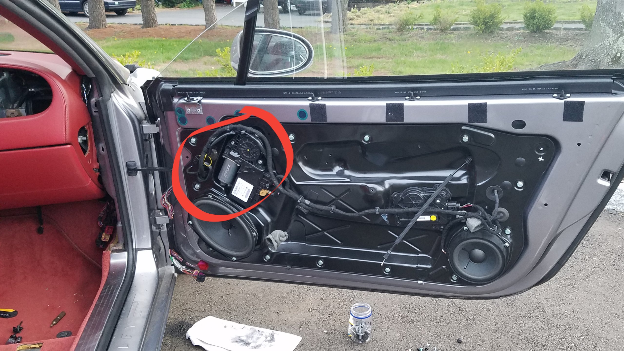

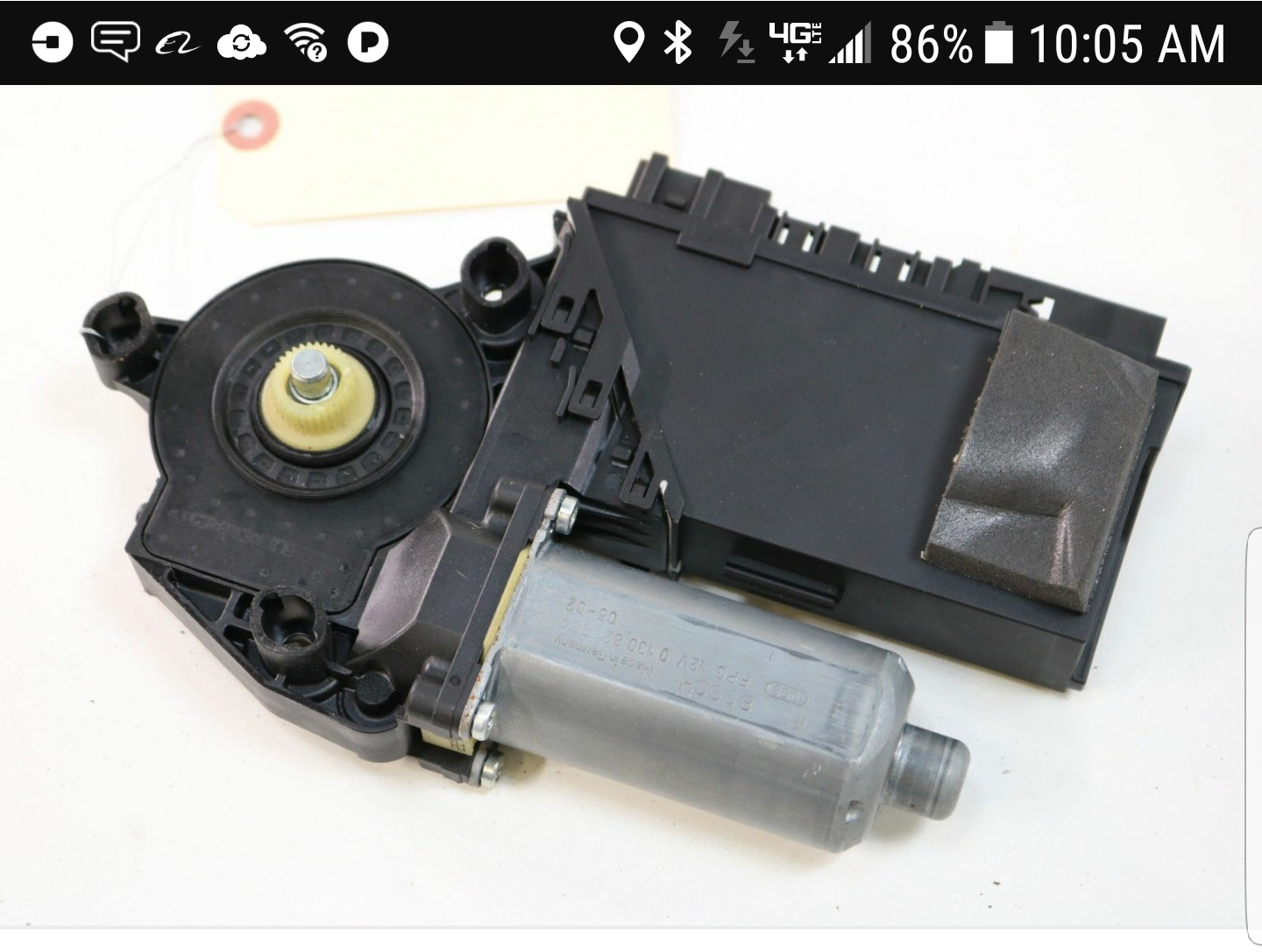

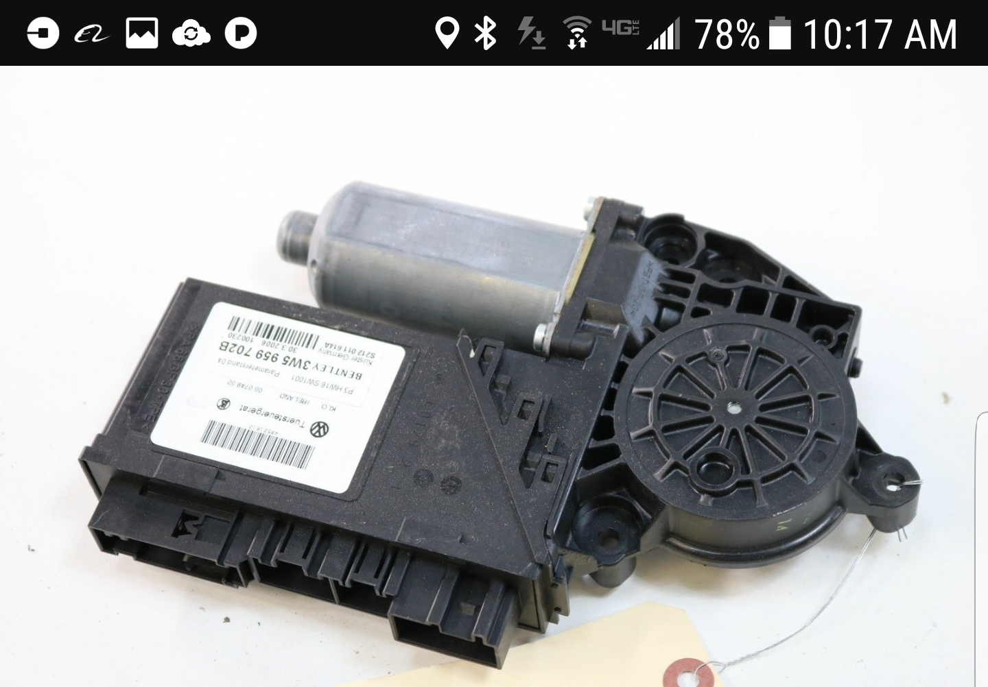

Hello Zissis,
Yes, the window lift motor/control module is located under the door panel and circled in red, it is a one piece unit that controls window and mirror for that door.
Also, have you scanned for fault codes, as sometimes clearing codes can bring the fault back to working order, until it fails again...
