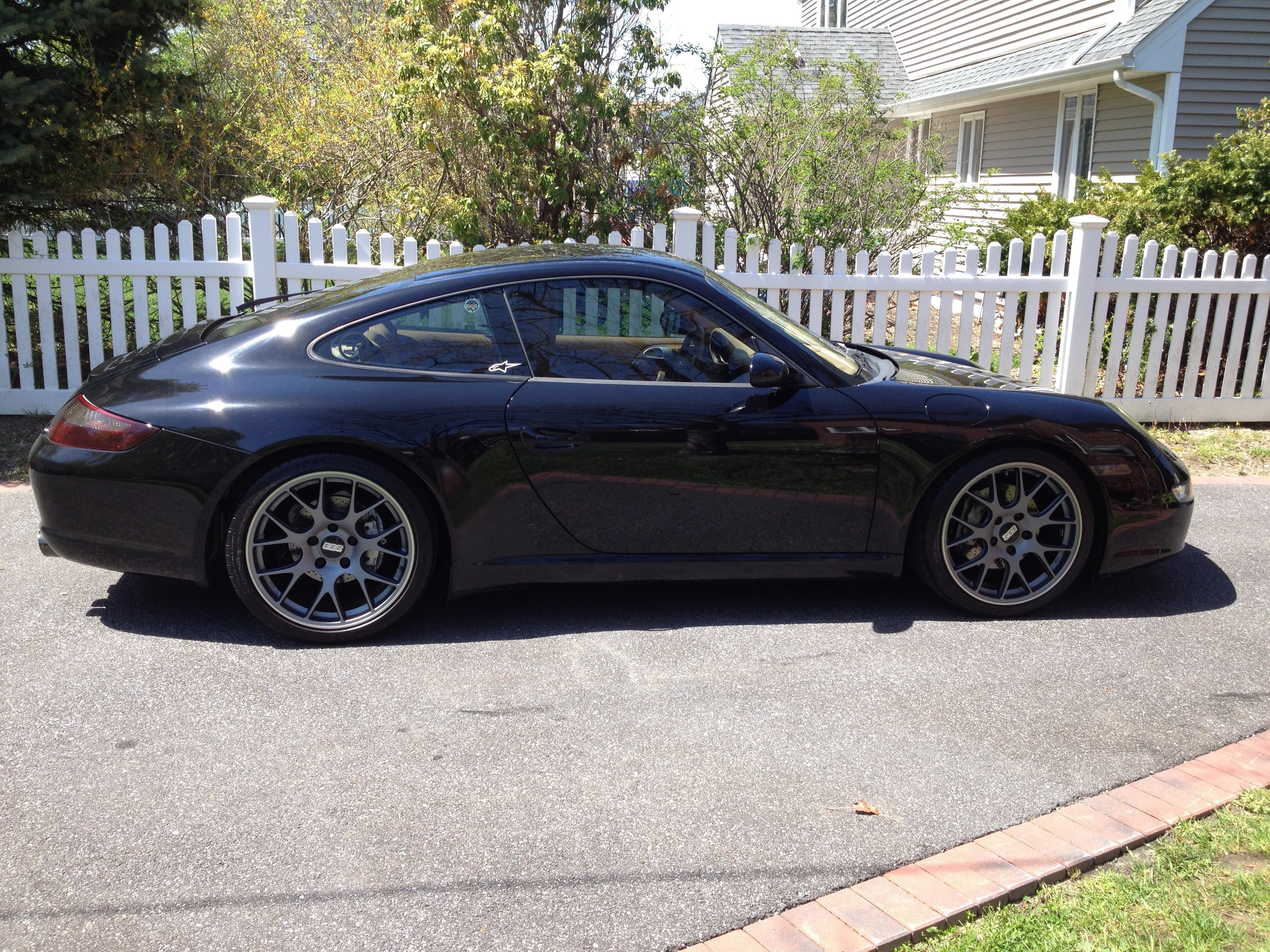

Thanks to Damon at Tire Rack I received my BBS CH-Rs on Friday. I had them mounted by Saturday afternoon.
I weighed the CH-Rs and the Vorsteiners. The CH-Rs are about 4 pounds a wheel lighter.
Love the look.
Thanks to all that chimed in and to Damon for his help!
