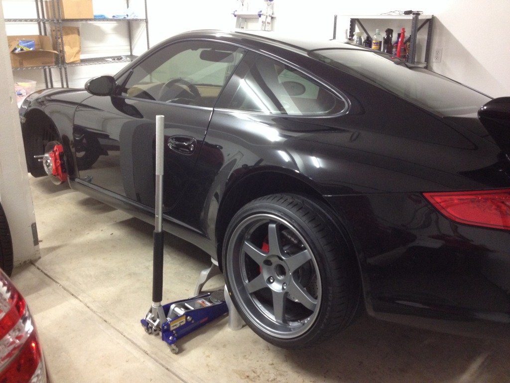

For the first time had to get all four corners off the ground at once.

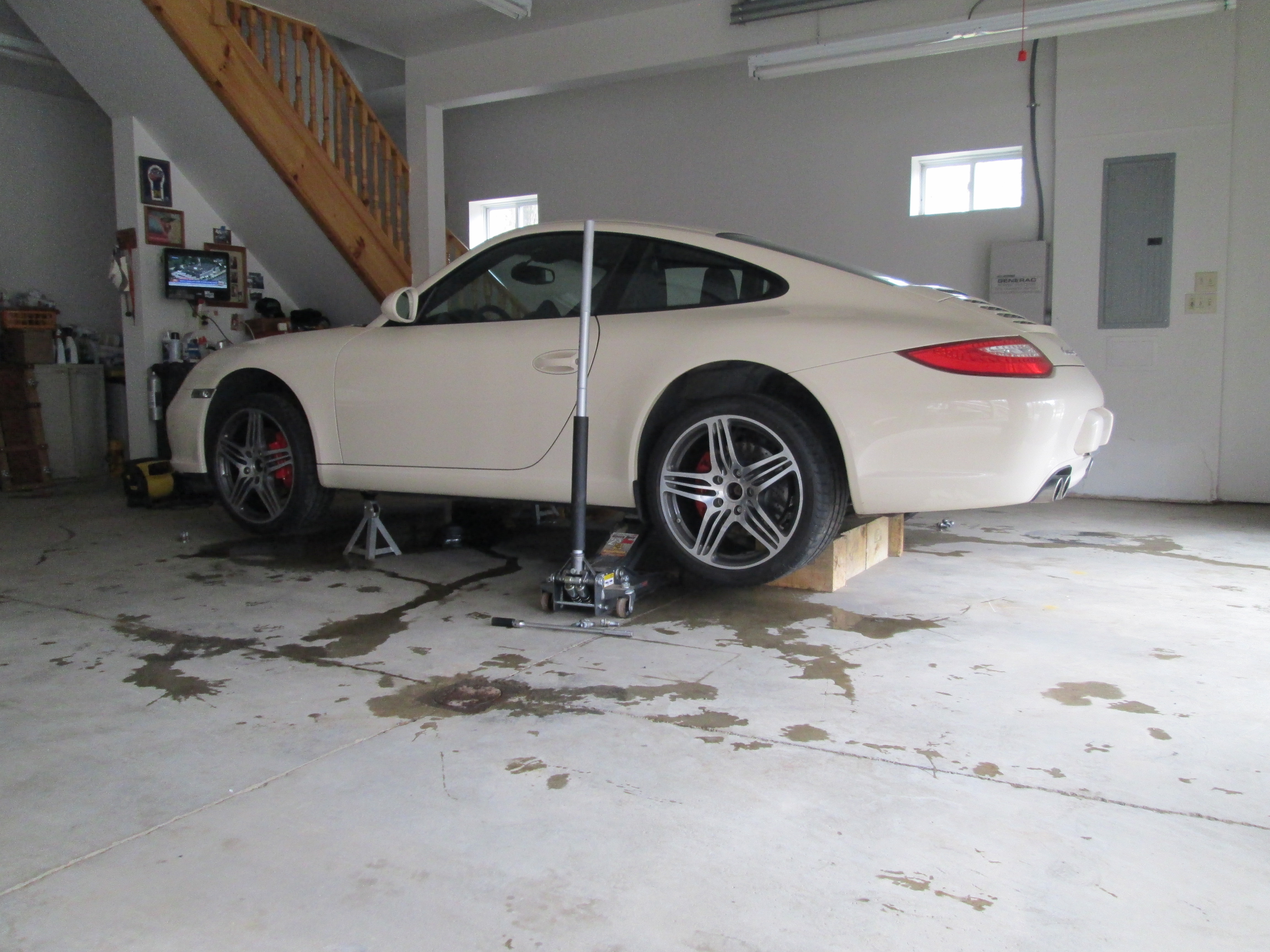

Here is a pic for those who may be interested. I jacked the rear side up one at a time(from rear side jack points) which also brings the front up to put a jack stand under the front (jack point)Same thing on other side. I put a few blocks under rear cross member just in case a jack was to go. I just wish there was another way to get another rear jack stand at the jack points without putting a jack under that rear cross member to lift it. I don t like that idea as I have heard some say it can damage motor mounts among other things ( don t know ) but didn t want to chance it.
Getting four new tires and also did a brake fluid flush and cleaned/waxed brake calipers .
(see tires for sale in the classified section).

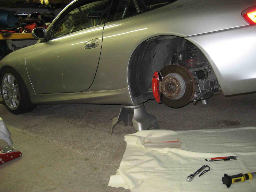

That's why I bought jackpoint jackstands (no affiliation). I just hated putting any weight on the motor mounts or suspension components. They are expensive but well worth the peace of mind.
I can remove both wheels after jacking the rear only and it feels super safe

Interesting, mind explaining how they work? Nice.

Here is a YouTube link which shows how the Jackpoint jack stands work. You can also Google their website.
They are definitely pricey, and unfortunately they aren't adjustable. I've been thinking of getting a set, but I am concerned about how much space I'll have under the car (you are limited to the max height of the jack stand itself). It looks pretty tight under there, especially if I had to do a lot of moving around. I've been holding off because I am wondering if it would be better to put that money towards a home lift.

Honestly I was concerned about this too but there's plenty of space. Ends up being higher than when I typically jack my car to work under there

jacking up the rear suspension at the right point is fine if its only for a minute while you place a stand under the rear jack point

why is it fine for a minute and not longer? some say it's fine and others say it isn't. Sadly no actual evidence of either (would need a randomized control trial). With the jackpoint jackstand there no guessing/speculating.

Do you have the standard-size Jackpoints or the low-profile ones? I have 5" of ground clearance and my jack will go all the way up to just under 15". I'm hoping the standard ones would work as every bit of extra lift will help. I can't stand working under a car when my nose is constantly scraping the under carriage.

Its most likely fine for a lot longer than a min, just not necessary as you only need it up long enough to place a stand under the rear jack point.
Also it's the only choice you have if you want to put it up on 4 stands.
I was advised to use this point by a Porsche technician.
Good photo of where to jack up the rear suspension - see figure 2

I'm a skinny guy - probably makes a difference but I use the low profiles and it works fine. I know that you can also stack a couple together to have more clearance.

how much clearance do you really need in the rear?
Check out this member's picture with the rear jacked up on jackpoint jackstands. Plenty of room to work on the engine.
