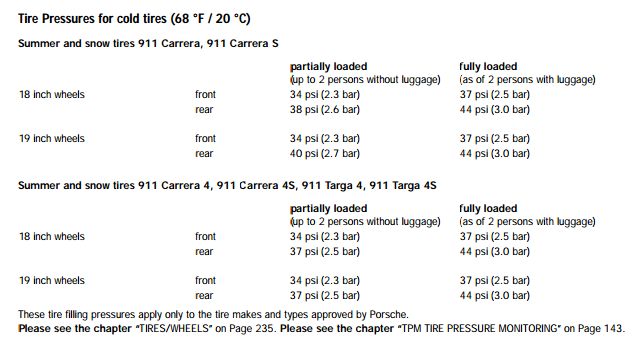

Had a look at some threads still have a few Q's...
I guess 33/39 is the general option for tyre pressure right?
The sticker on the door is for full load only right? Is 33/39 correct if it's just the driver?
What does cold pressure mean? Does it refer to ambient temps?
Cheers

Since it seems you may not have the manual, please see attached. Note that the pressures are slightly different depending on several factors.
Thanks storm, I can see now why people are doing 33/39, taking 1 psi off if it's just the driver, as 34/40 is for 2 people.
