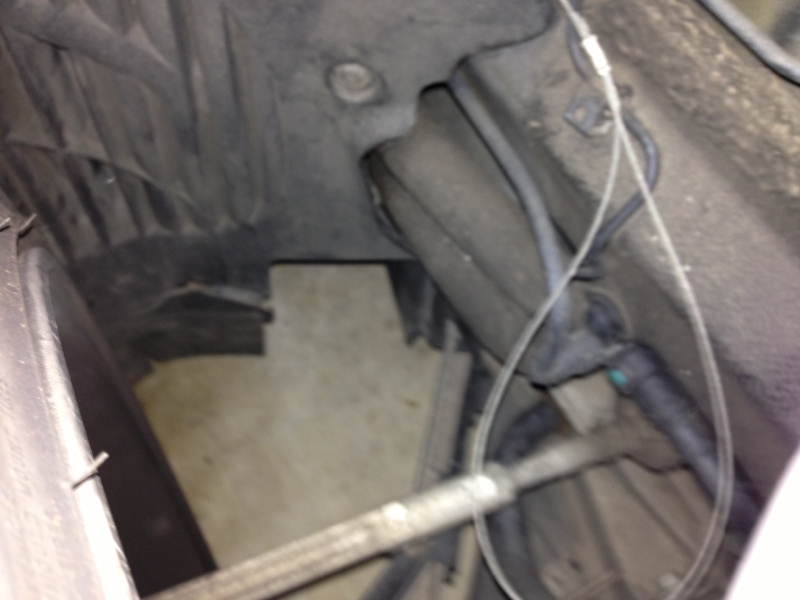

Once you figure out how to open the lid, you might want to extend the cable into the rear wheel well. And ditto for the frunk!
ID:	384874   Click image for larger version
