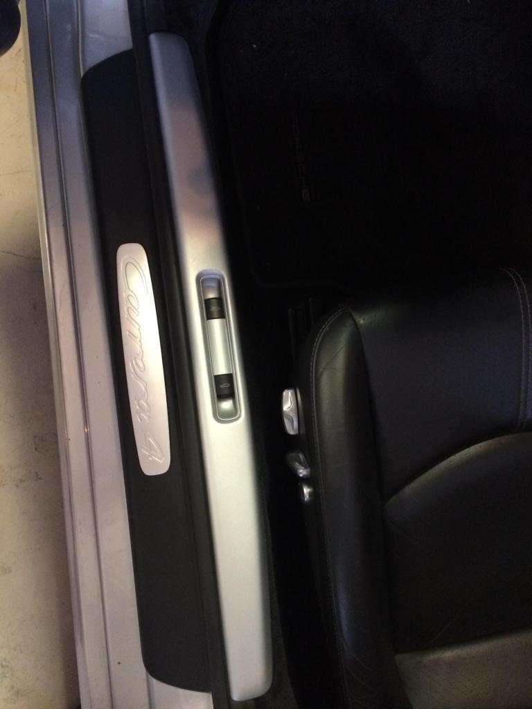

Here is my $6.00 mod. Painted my interior door sills arctic silver to match the rest of the car. They were really looking ratty.
Very easy to do, most difficult part is stripping the soft touch paint. Soaked them in water overnight and then used a scotch brite stripping pad.
They turned out very nice.

Old Jul 5, 2014 | 01:02 PM
C4SNY's Avatar
Joined: Jan 2014
Posts: 60
From: NY
C4SNY has much to be proud ofC4SNY has much to be proud ofC4SNY has much to be proud ofC4SNY has much to be proud ofC4SNY has much to be proud ofC4SNY has much to be proud ofC4SNY has much to be proud ofC4SNY has much to be proud of
Looks great! Very nice touch.
Fantastic looking. Where did you buy the paint from? Reference number?
Bought the spray paint from scratchwizard. They have all the Porsche color codes in aerosol.

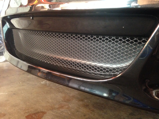

Here's my $3 mod. Front grill mesh grill. Made from rain gutter grill purchased from Home Depot. Requires removing the front bumper cover which is pretty nerve racking when it's your 1st time doing it. Once you know how it's done, it takes less than 30mins to dit it. You'll need help to hold the bumper up while removing/installing the wire harness and headlight washer hose.
The grill is actually painted in black but it looks lighter in the pics.

Old Jul 6, 2014 | 07:11 PM
CHAOS236's Avatar
Joined: Jul 2008
Posts: 506
From: Columbus Ohio
Rep Power: 39
CHAOS236 is infamous around these partsCHAOS236 is infamous around these parts
Very nice, just had mine done when painting the nose.
