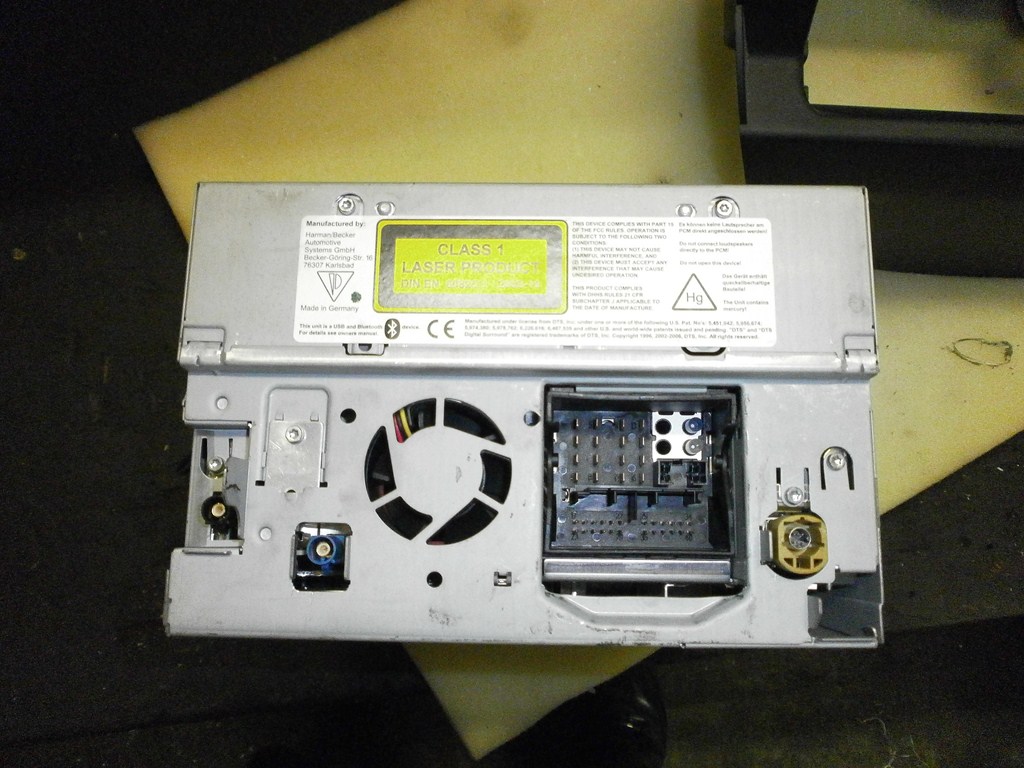

Here's a pic of the back of the PCM3 with Bose. Notice there are some empty connector spots.
Presume one would simply need a non-Bose oem wiring harness?

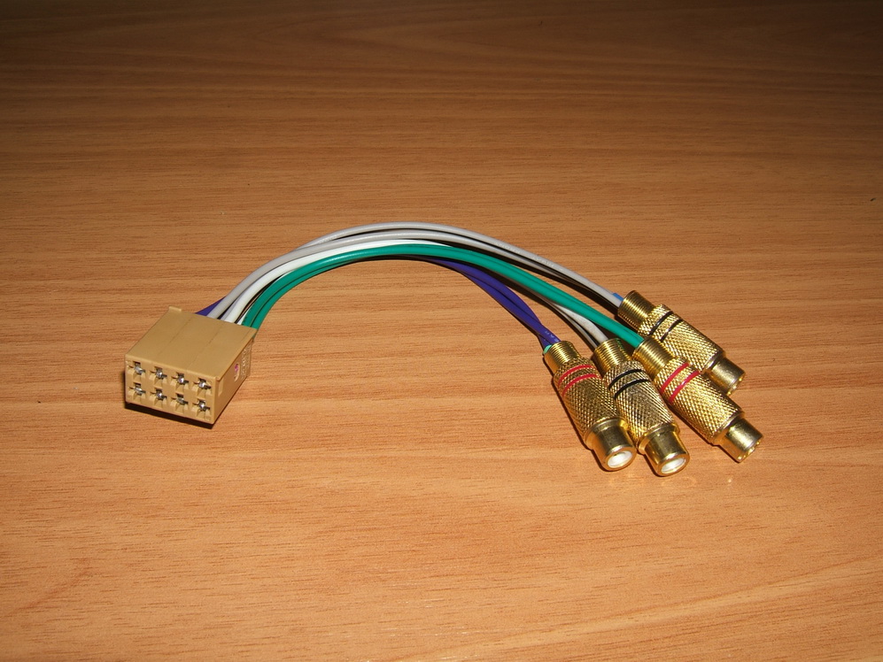

Originally Posted by Serg124
unable to buy this. only self-made harness.

Originally Posted by ryem3
Then you can get the plugs? Without the plugs or harness that would be a real nightmare.
of course plugs and pins are available, 3B7035447 plug and N90684505 pins
version of result on photo, not mine but sure gives the idea.

Hmm, neither of those harnesses look like they would plug in to the back of my PCM3. Something isn't right.
Edit - I see a spot where another 8-pin connector could go on the PCM but the pins are missing. This is on a PCM3 w/ Bose, US version. Have a feeling we are missing the circuitry for the pre-outs.

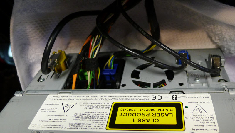

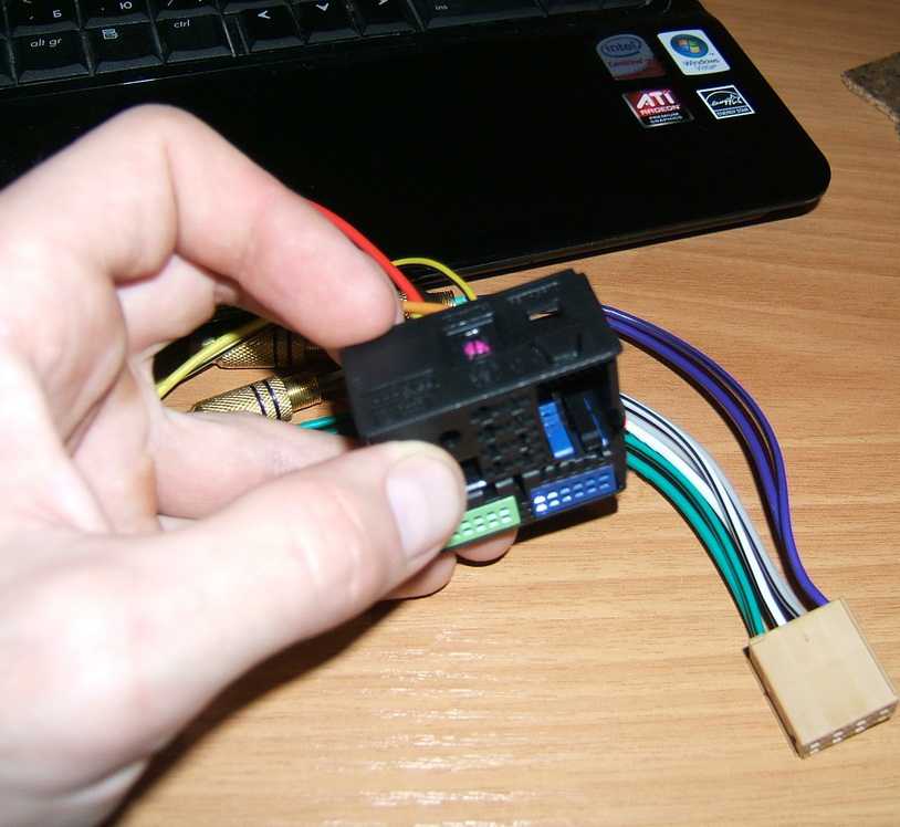

what pins are missing, what you talking about?
