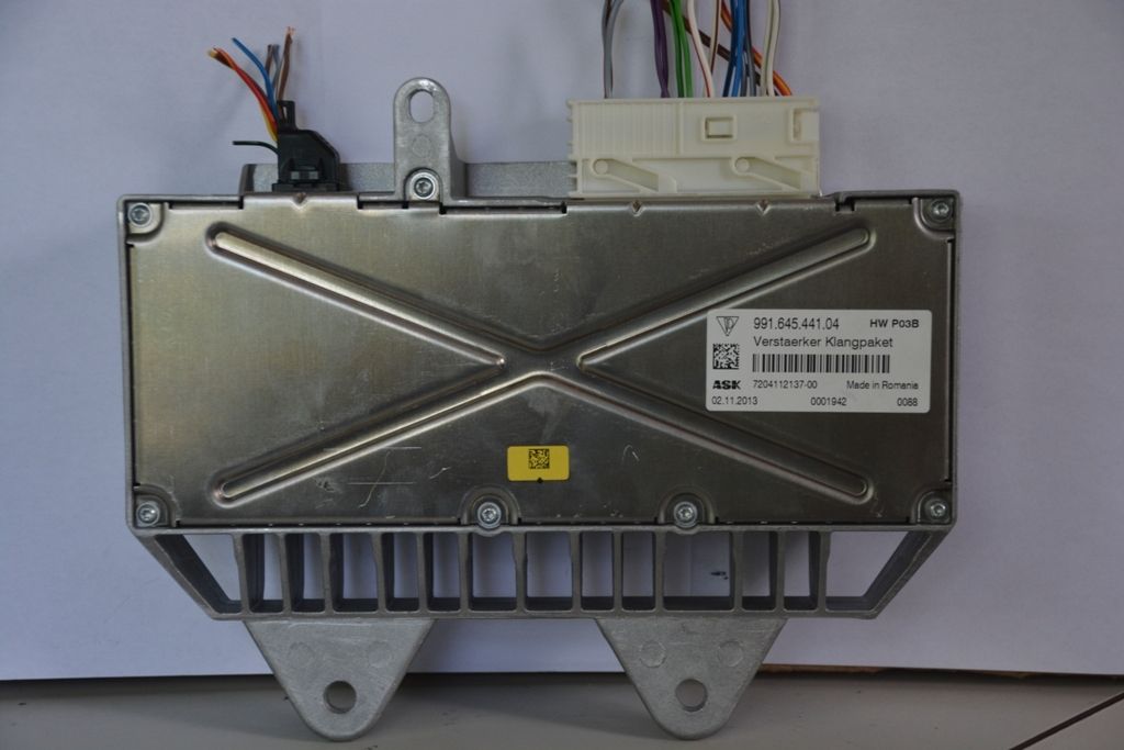

in what you beleive - what you see with your eyes - or in rumours of those who even didn't remember that bose is only option?
pcm is NOT bose head.
pcm3 cant live without amp
two options still available - nonbose CAR or bose car
this mean different amps speakers and wiring, pcm is same
nonbose amp called ASK
ASK amp has matched pcm low-level analog inputs.
instead of ASK amp can be used any other aftermarket - only need is REPROGRAMMING pcm3 to NONBOSE option - or will be NO SOUND.
