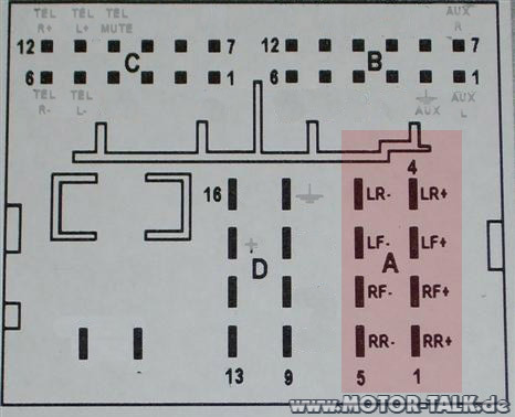

Originally Posted by Serg124
of course plugs and pins are available, 3B7035447 plug and N90684505 pins
version of result on photo, not mine but sure gives the idea.
Serg, obviously you've done a ton of work reverse engineering the Porsche audio system. I've read the .1 to .2 conversion, which is a total nightmare. This seems like child's play by comparison. That harness and plugs is a well done conversion. The real complexity is knowing which pins are which outputs. Such a harness would vastly simplify an aftermarket amp install. Someone could easily sell that wired $25 plug for $100 on the US market.

no complexity at all. this is standart plug. and this outs are standart-wired.
If anyone has their US version PCM with Bose pulled, please see if the pins highlighted by Serg exist on your PCM. If I remember correctly there was no pins on my PCM where that plug goes. (Which could explain why none of these aftermarket harnesses are available in the US.)
what pins are missing, what you talking about?
