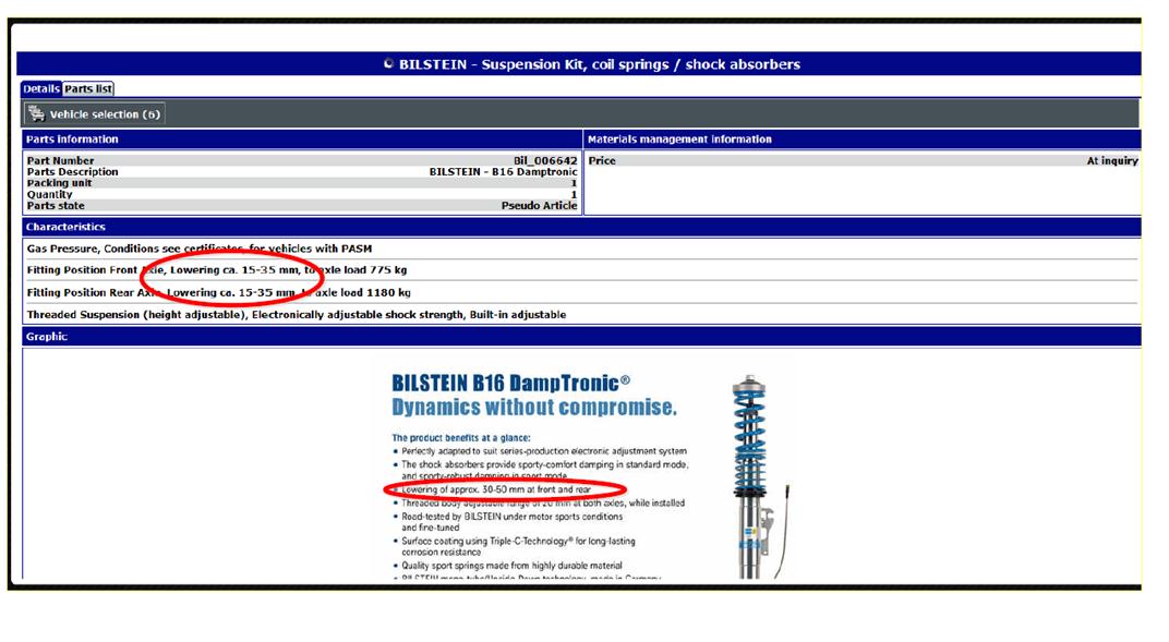

Hello and greetings from Australia,
I have done a lot of searching on this but was unable to get the answer I am looking for.
I have a 997.1 C2S with PASM and need to lower the car while keeping the PAMS working. I like the low stance look and drive the car every day. It will not see any track use. The Bilstein B16 Damptronic coilovers Part Number 49-115604 for my model has condradictory figures in lowering height. I have contacted Bilstein and a number of shops in the US and Europe without a single reply, and was hoping someone on this forum who has the coilovers can set the record straight.
The Bilstein website has 2 sets of ride height figures. One is 15~35mm drop and the other shows 30~50mm drop.
If you have the damptronic coilovers, I would love to hear the ride height drop you were able to achieve. The H&R springs get to about 30mm drop and if the coilovers only go to 35mm then I would not be cost beneficial to pay a lot more money for a 5mm drop.
Would also appreciate recommendation of shops who can supply the coilovers.
Thanks in advance.
Name:	Coilovers 49-115064.jpg

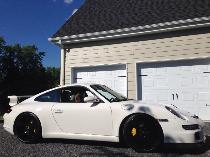

i ordered from awe. Far from super stiff... Have them maxed out... I'm running pzero tires on 20" and its good. I'm hoping when switching to michelin will be harder all around

Thanks for the reply mk3boy.
Car looks great and sits just right.

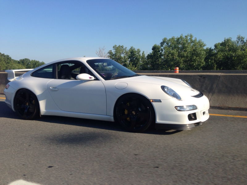

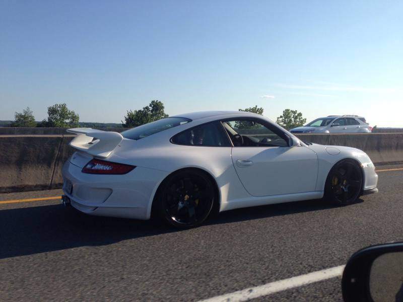

awe tuning excellent service
i love the bilsteins. Gf loves the pasm disable button for comfy mode / :

btw after corner balancing my coils are pretty spun all the way down maybe 1 turn left or so. Sits perfect.

Thanks for providing those extra photos. It has also given me an idea on ground clearance with the GT3 front bar. Any issues here?
Yep totally agree, sits perfect.
