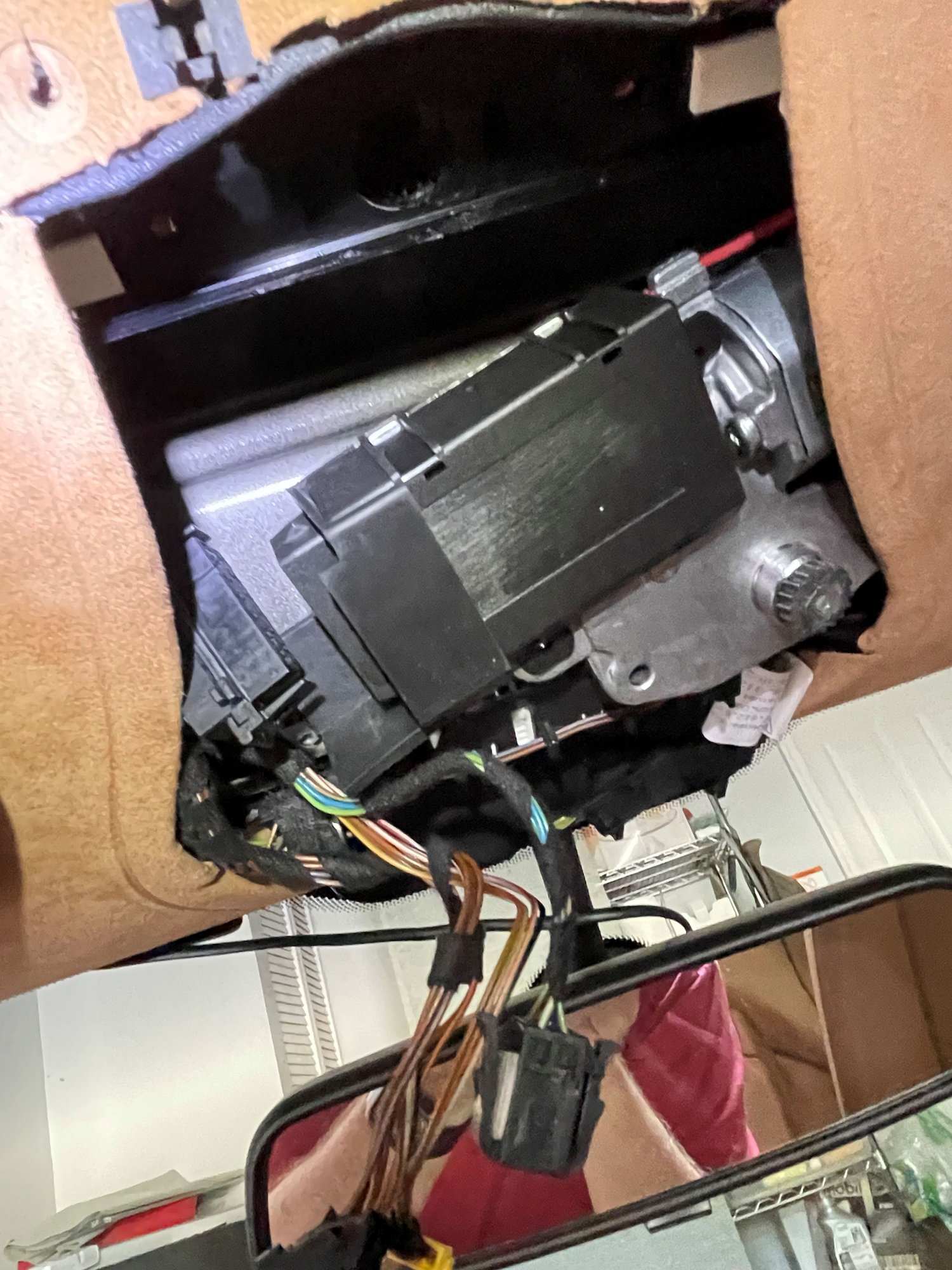

Sliding Roof Motor / Sunroof Motor replacement
New "Sliding Roof", aka, Sunroof motor installed. I got it for $467 from a local dealer order - 99762421300 - Porsche Sunroof Motor | Porsche Atlanta Perimeter, Atlanta GA (porscheatlantaperimeterparts.com). Part number is: 99762421300.
The installation was fairly easy, and I followed this 996 guide which was close enough - https://www.pelicanparts.com/techart...DY-Sunroof.htm
Notes and photos:
1 - Removing the garage door switches: there is a small slot, one-eighth inch maybe, on the front edge toward the windshield. If you pop a small screwdriver in there and pry, the switches pop out easily enough. My switches have always bothered me as the far right is the 1, then 2 & 3 coming toward the driver's side. As if they are UK installed. Unfortunately, they cannot be relocated to make more sense due to the way they fit - the plug is in the way for reversing them, so don't bother with that if you have the same issue...
2 - The two screws to release the dome cover were difficult to break loose - I had a T-handle screwdriver that gave me enough leverage to start them. With the screws removed, I was able to pry the dome cover with a soft trim tool starting at the edge near the sunroof.
3- With the dome cover open, you can slide it back toward the mirror and it will release and come free from a few support clips. There is a rubber grommet on the cover where the mirror stalk fits - don't drop it or lose it and note how it fits in case you must put it back on.
4 - I removed the plugs from the sunroof switch, the homelink switches, and the dome lamp switch - those last two were a nightmare and I'm not sure if I have bad technique with those plugs or if there is no easy way. They seem to have some sort of area that needs to be compressed to release a "pin" that holds them it - the pin is visible on the dome light plug, but hidden on the homelinks. So if you don't need to unplug these, maybe don't!
5 - Now you can see the motor and if you have a replacement, you know what you are looking at and can see the two Torx screws you need to remove to take it out. Remove the two screws.
6 - You'll now think this will be impossible to do without removing the roof liner. Relax! There are two screws into the roof liner near the motor that were hidden by the dome. Remove those. Now you have just enough give in the liner to carefully get the motor out.
7 - Now the motor can be rotated toward you to release its gear from the sunroof track gear. When you do that, you'll see an airplane wing shaped washer with a hole that the motor gear goes through. Be careful to note how the washer fits and catch it as it will fall off the motor as you rotate it so that the gear is visible.
8 - Work the motor to the right so that the plug on the left is just exposed enough to unplug it. Now carefully work the plug side of the motor out through the roof liner hole and then slide the motor to the left and out. Viola!
9 - Slide the new motor in, gear facing you, then plug it in and replace the washer that surrounds the gear! Now rotate the motor back so the gear meshes with the track gear. Replace the two Torx screws.
10 - Test now. With the power on, hold the forward sunroof button for about 10 seconds until a rest process starts where the roof will cycle through all the open / close positions and then return to closed. If that goes well, then you are set!
11 - Replace the Dome Cover hooking it in near the windshield / mirror and then snapping it into place taking care not to crush any of the wiring. Install the screws into the dome cover and then the homelink switches.
12 - Get a beer! You deserve it.
Remove those two screws near the clips in the roof line to make removing the motor easier.
Here is the motor rotated forward exposing the washer and gear. Remove that washer and put it on the replacement motor.
Motor pushed to the right so the plug on the left can be unplugged. Now the motor can be pulled out.
