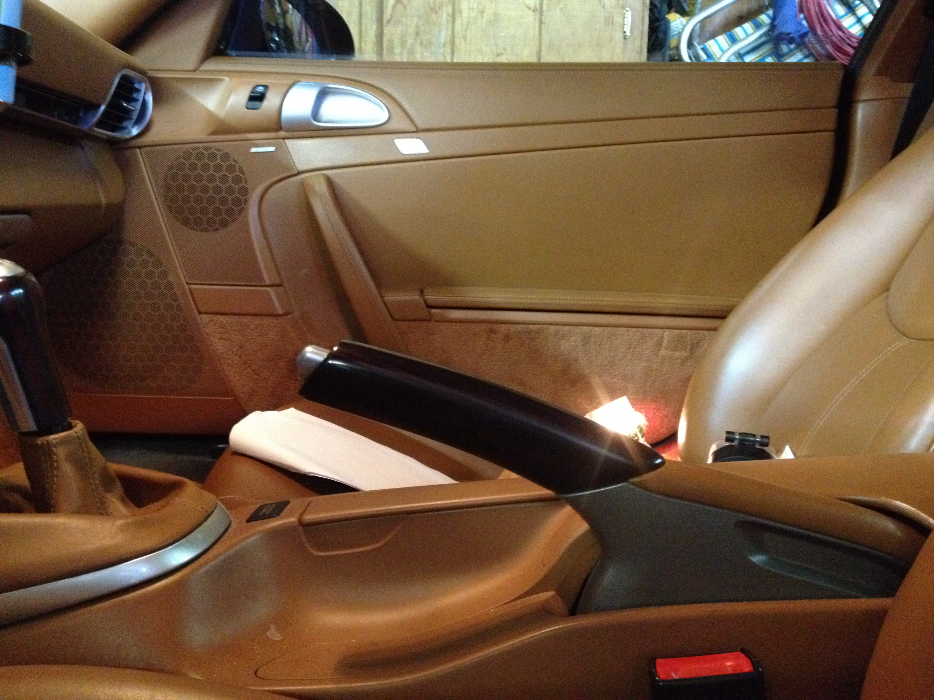

When I go to my parent's house and park at the very steep incline, my total clicks is about 7 clicks.
NOTE: Number of clicks does not equate to the condition of the ebrake. The clicks are generated by the "teeth and the locking mechanism."
Here is mine set to "maximum" ebrake for steep incline; I have the ebrake and window frame taken as an angle reference point. If yours is any higher, then you might need to investigate your ebrake.

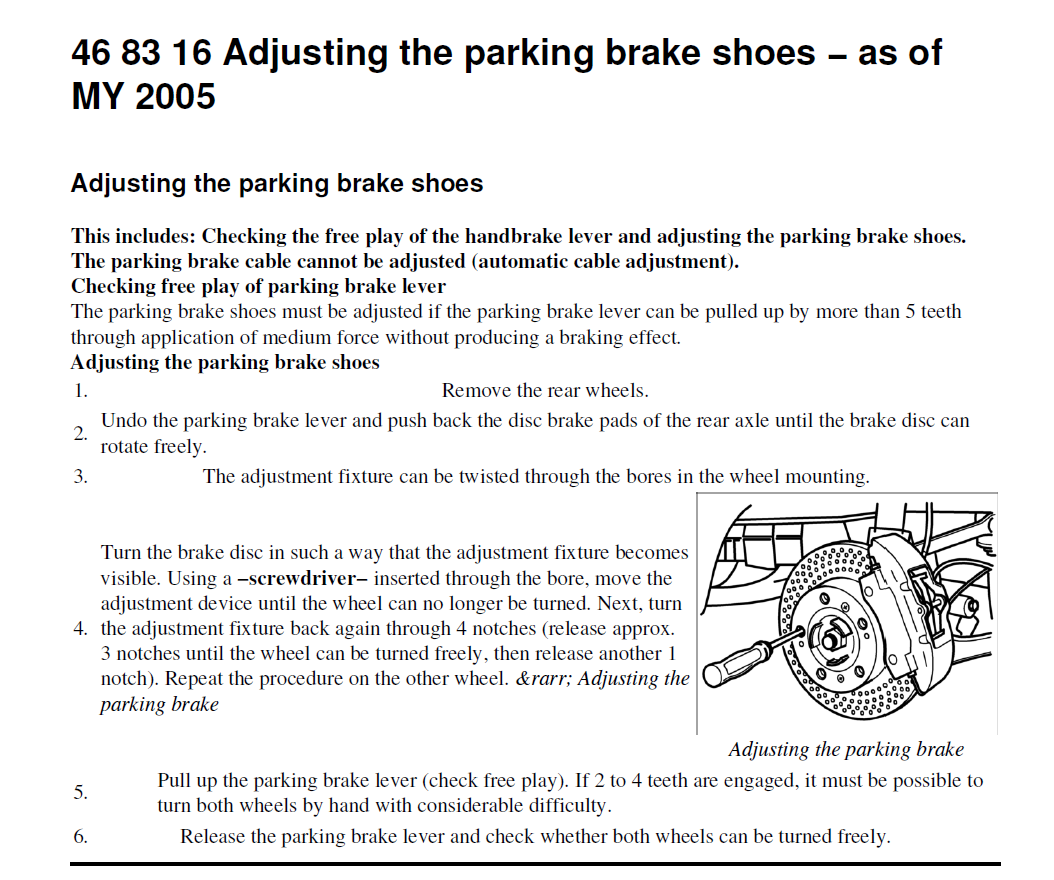

I found this. Check it out for applicability -- use at your own discretion.
As you can see, 2-4 clicks is considered a freeplay.

thanks cab83, I ll have to re read those direction a few times, LOL.

I m going to pull wheels and see if it looks the same as the 997.1 direction posted by CAB...

update/ The above directions are the same on the 997.2 .
I confirmed this with my dealer tech.
As far as my light being out, the dealer said it s not regulated by the rear pads/adjustment but it is a switch in the console and it goes bad very often.
Thanks, With the help of CAB83 (diagram) I posted again so it can go in the DIY section .
