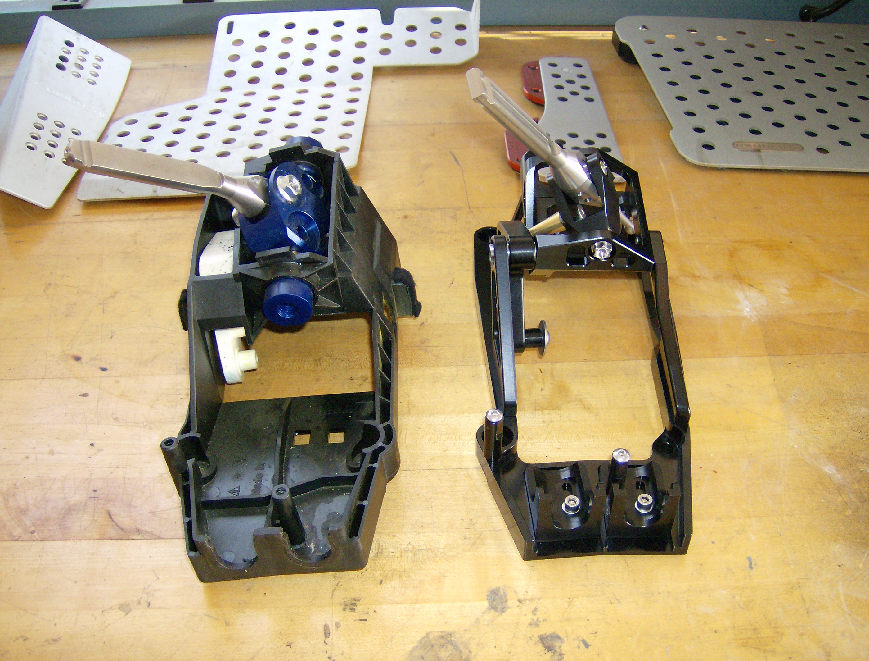

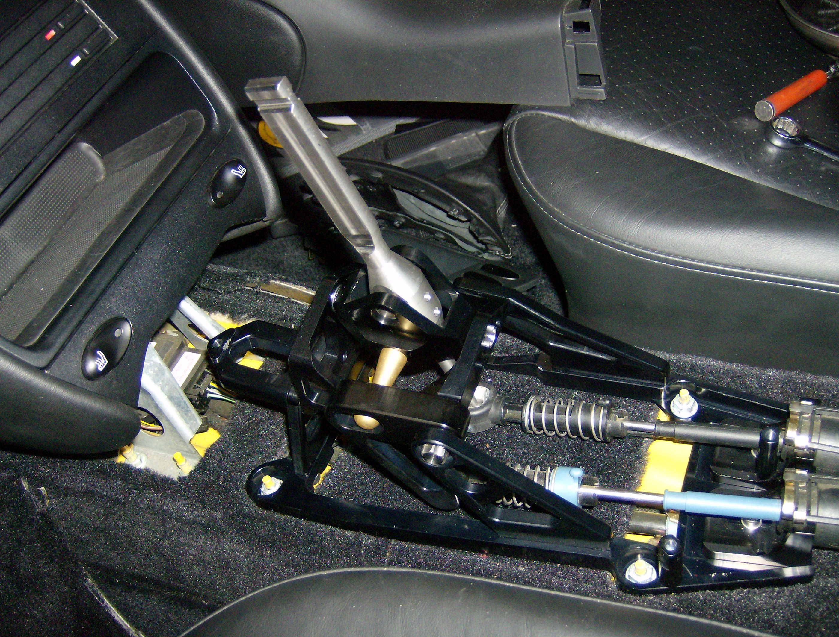

any shifter that has a plastic housing is just junk. if you want a shifter thats adjustable, rifle bolt shifting and all aluminum housing look at the numeric. not cheap but its the last shifter you will ever buy for your porsche. there is ZERO side flex with this shifter.
