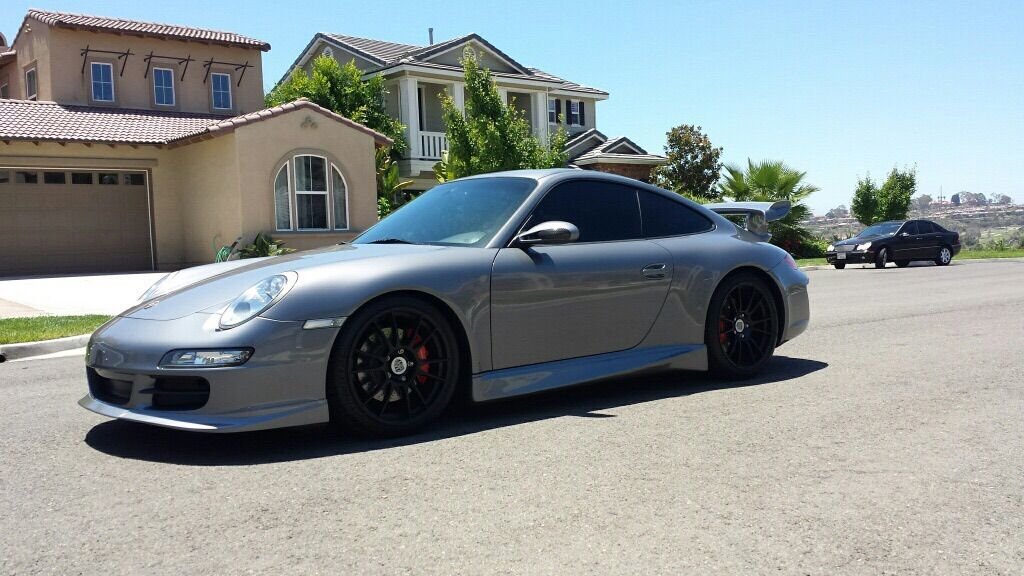

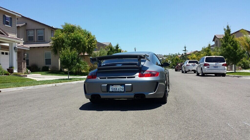

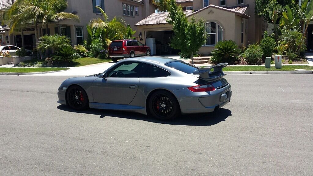

NR Auto GT3 997.2 bolt on

Evil997, you are the man ! Thanks for taking the time to post the pics. I have 2 questions for you:
1. What is the install like? Do you need to remove the stock spoiler and wiring harness?
2. What are your thoughts on the overall quality and fitment?

The bumper does not need replaced. You do need to install a GT3 wing harness and have the error fault code programmed out. A beep goes off whenever you reach speed. No big deal as mine still needs programmed.
Quality and fitment is good. My wing does need a little more adjustment. When I open the decklid the blade of the wing actually sits on the third brake light. I probably need to bore out the mounting holes a little in order to make the clearance.
It is a fiberglass piece so sanding was necessary, as expected. Overall I am very happy with the look of it.

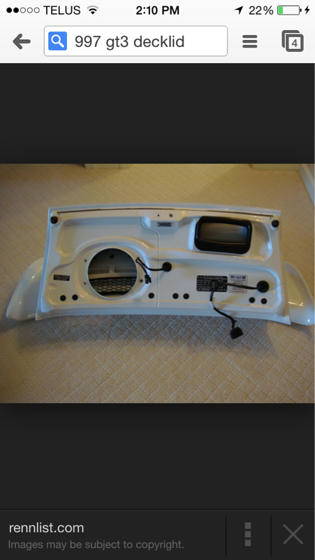

There is a difference between the Aerokit and GT3 wings. The Aerokit wing works with the stock airbox. Mine went on without a hitch. I believe the GT3 wing draws intake air differently, and requires some plumbing mods. Is there anyone here with a true GT3 wing that knows for sure?
Old Jan 6, 2015 | 06:12 PM
mk3boy's Avatar
Joined: Apr 2013
Posts: 279
From: Montreal
mk3boy is just really nicemk3boy is just really nicemk3boy is just really nicemk3boy is just really nice
miami4me you are right.
stock or replica wings have left side air intake. oem gt3 997.1 is right side intake. 997.2 to 997.2 might be easier not sure
pic is oem gt3 997.1
