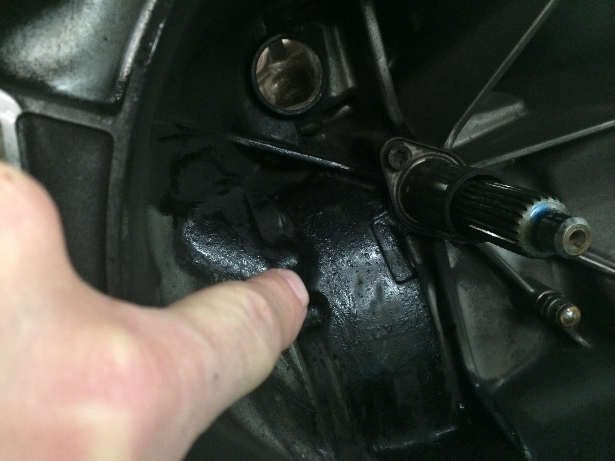

I have been dreading this day, I have been seeing a larger and larger spot of oil under my car. I finally deciede to do something about it and brought it to my independent Porsche mechanic. My car has the updated dual row bearing.

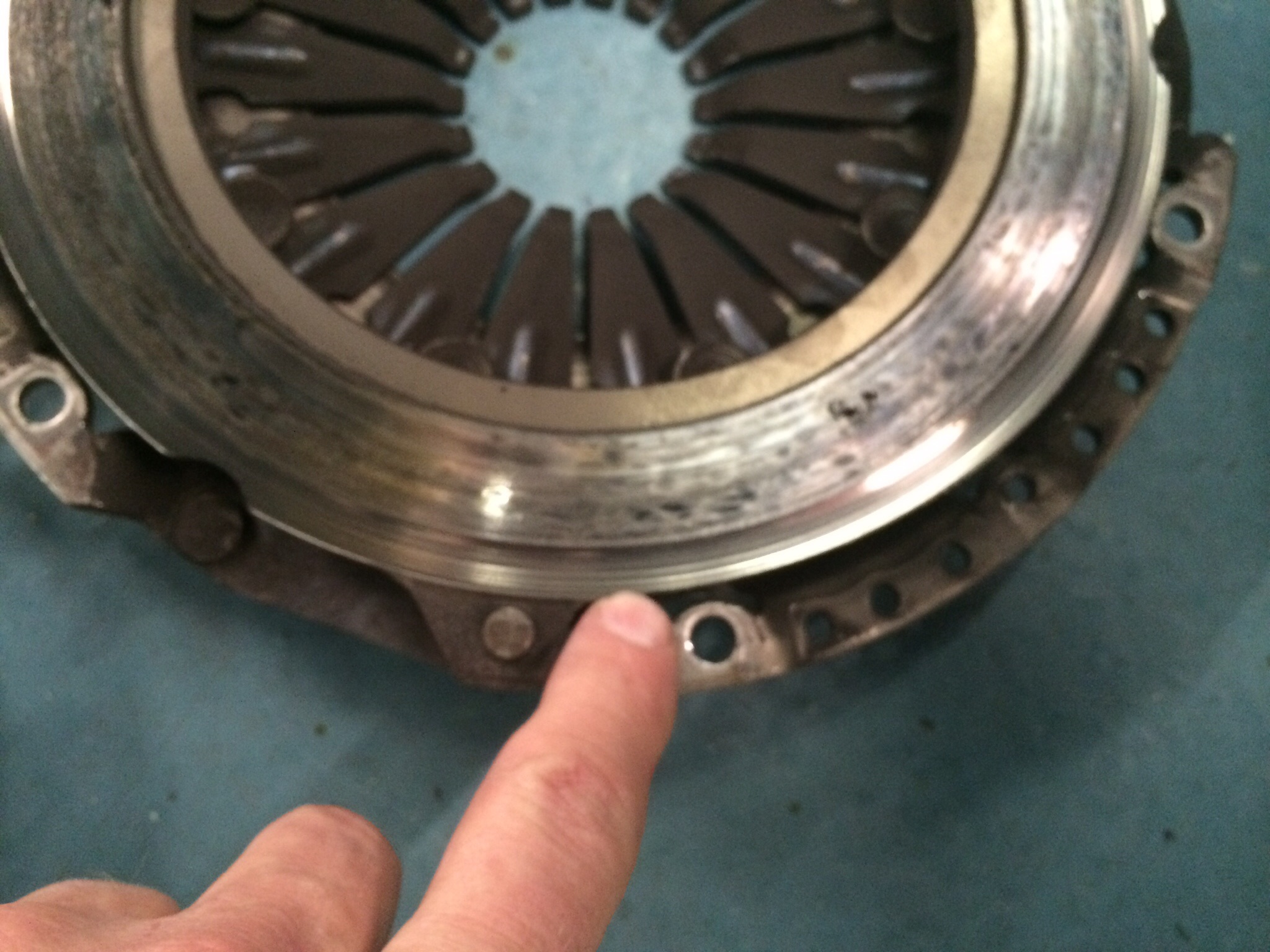

At 47000 miles the clutch which worked well and felt fine looked like this! The clutch disc was thin but the pressure plate was scored.

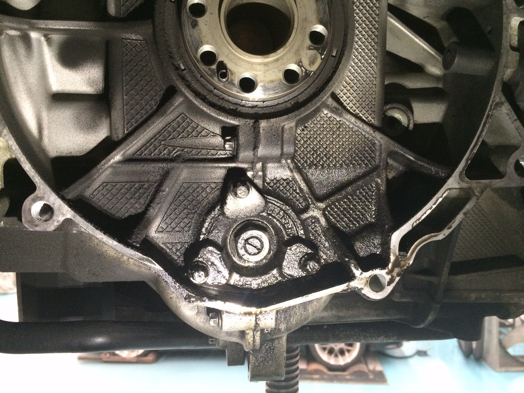

So if the IMS looks good when the cover comes off I am going to install the Dirrect Oil Feed adapter to prevent any further trouble, a new clutch and pressure plate, new slave cylinder, clutch fork and bearing.

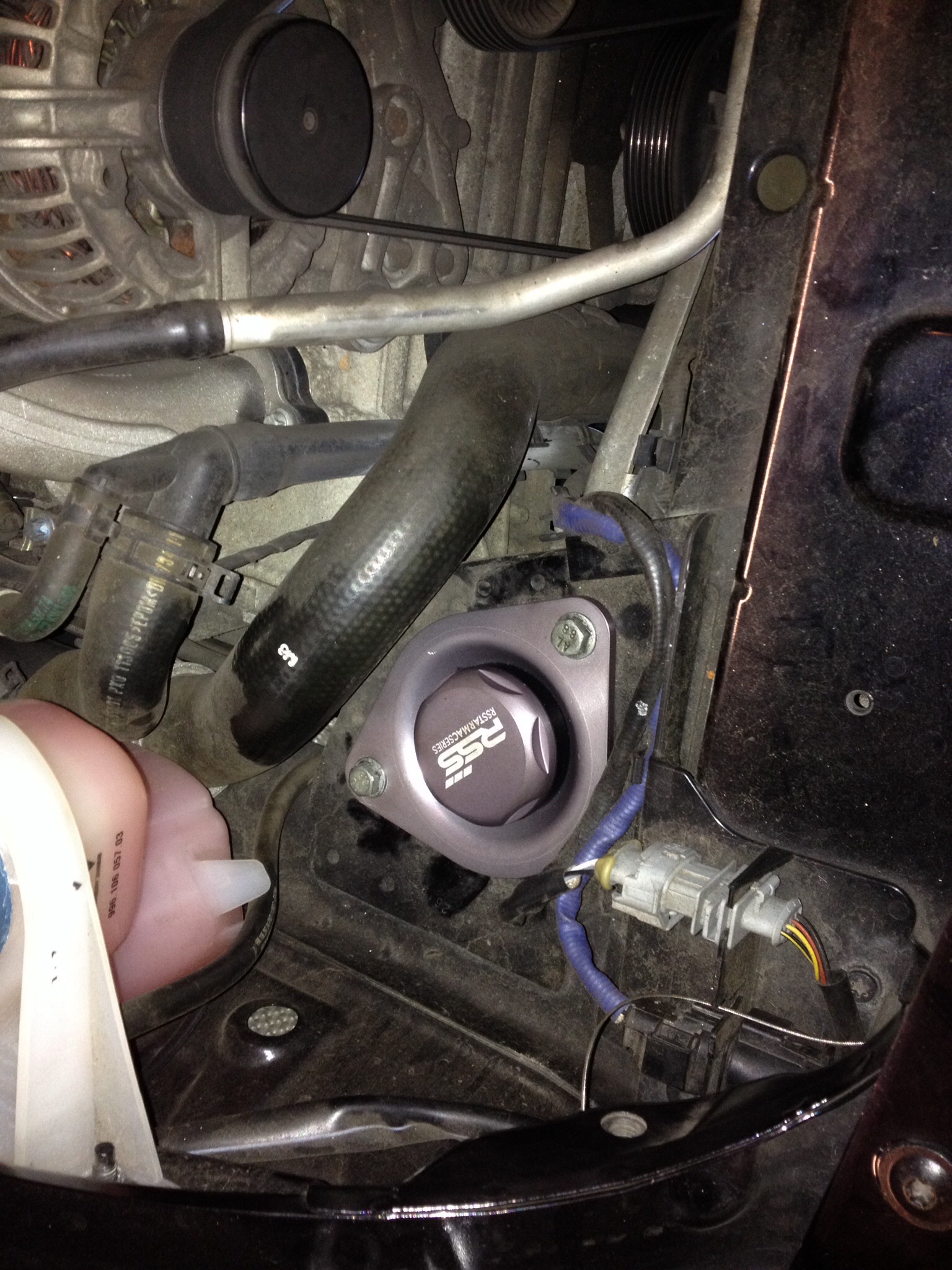

While it's there I am going to do some suspension mods. Just last week I installed RSS engine mounts, easiest mod ever and their beautiful, too bad there hard to see.

what is the remedy for the ims if it is already the larger (presumably stronger) bearing.
for certain not rms leak?

Perhaps the bearing is OK and it is only a leaky outer seal?

looks like you caught it early - no catastrophe...

Karl B- what year is your car? I have considered doing the IMS direct inject on my 2006 997S just so I can sleep at night. Very nice mounts!!! Sent from my iPad using 6SpeedOnline
