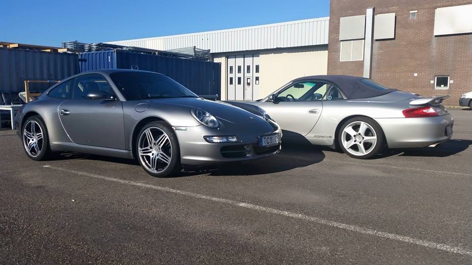

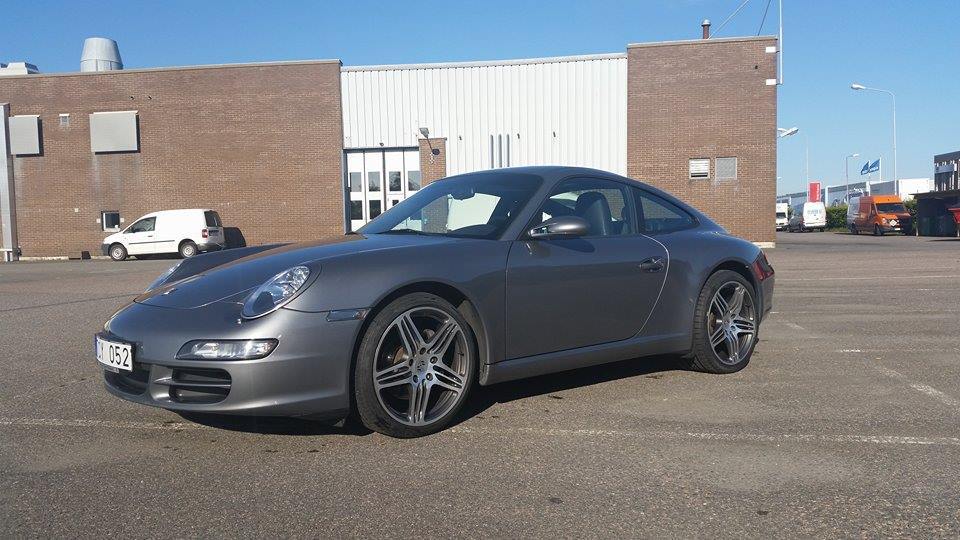

The result was great. Have to lower it a few cm, but apart from that, it looks great!
Bonus picture with my 996:
With kind regards, Jonathan.
