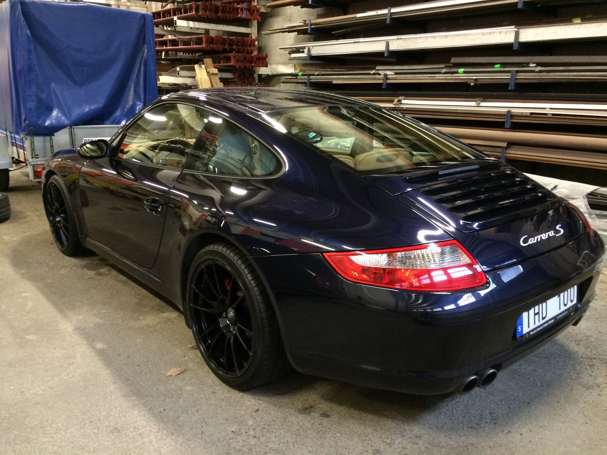

After driving my c2s stock for about a year i just purchased a pair of 19" OZ Ultraleggera. Since I wanted a flush look i decided to go with ET49 front and ET50 rear. As I was looking I came across a used set that was well, more os less new but the previous owner had fitted a pair of Nokia WR (winter) tires on them.
My thought was to transfer my 295/30 P-Zero´s from my OEM wheels. But after looking at the tires it looks like they are a bit wider than "needed" and not that slanted as the winter tires.
So now the question. Anyone running the P-zero setup without problem or have a top-tip of what tires to run to get a slanted side of the wheel to prevent rub?
Below is a pic of the car with the wheels test-mounted.
Tanks in advance!

If they're the same width as stock wheels (19x8/11) then you're going to want to stick with the stock tire sizes (235/295) and you shouldn't have any rubbing but looking at your pics I can see that you don't have any, or much, negative camber so you could get it aligned and dial in some negative camber to tuck the wheels under the fender lips slightly and then you definitely won't rub plus you would handle better in the twisties.
