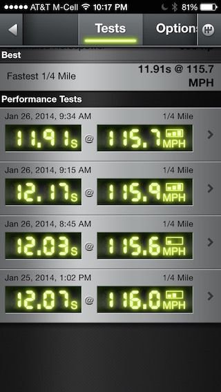

I guess all of this explains why I got an especially good time in a test run of my car in the winter of 2014 in 44 degree temperatures using launch mode in Sport Plus. The app I use, which uses accelerometer data cross-correlated with GPS data over a quarter mile reported I ran a 3.86 second 0-60 and an 11.91 quarter mile at 115.7 mph. In the attached photos, three bars means it was a high quality run (the GPS data verified the accelerometer data it used gave it consistent readings). Yes, I know there could still be some error, but I have no doubt it was very close. You could feel it was a perfect launch. Note that the peak horsepower number you see on the display was the estimated rear-wheel horsepower based upon the weight of the car and driver I provided.
One more interesting thing to note: You can see the PDK shift points on the graph. Notice the forward acceleration G peaks on the graph when it shifts. Notice that there is no significant drop in Gs just before the peak when it shifts, something you would normally see if it was a manual tranny. That is where the PDK gets its 0.2 second typical advantage in 0-60.

Originally Posted by StormRune
Hey Stormrune, what app did you use for your 0-60 timing?
