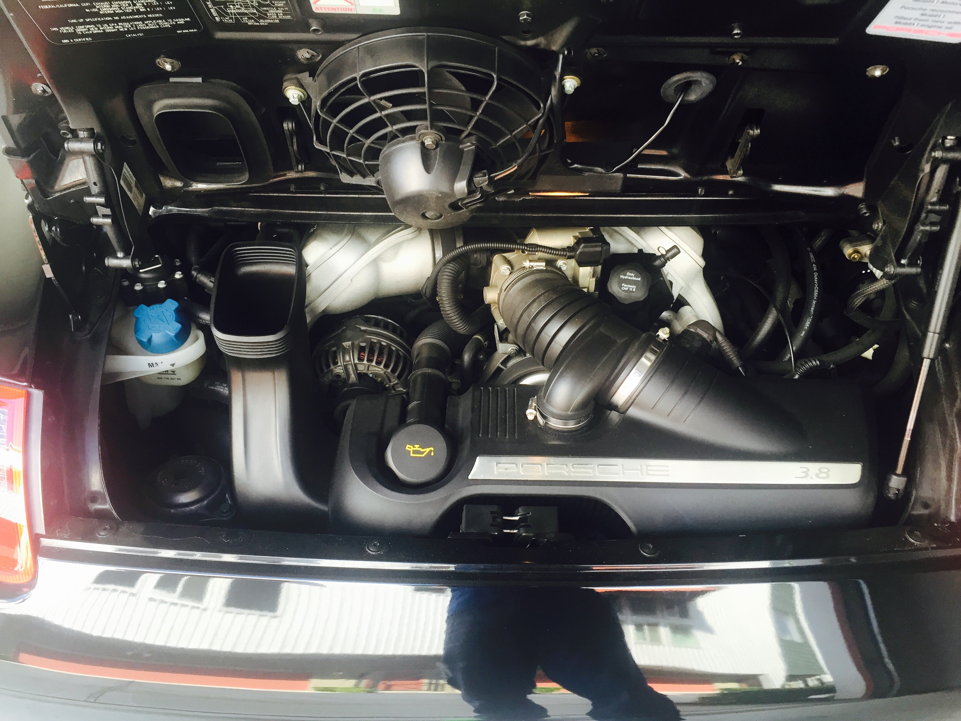

Here is a picture. Hopefully you can see what I can't.

Your engine looks like it's in the right place What could we possibly see that you haven't been able to see? I think heat could be part of the issue for you. As others suggested if you can check with previous owner about a possible tune that would help narrow down the problem too. Good luck.
I see the problem...you are missing the turbos
