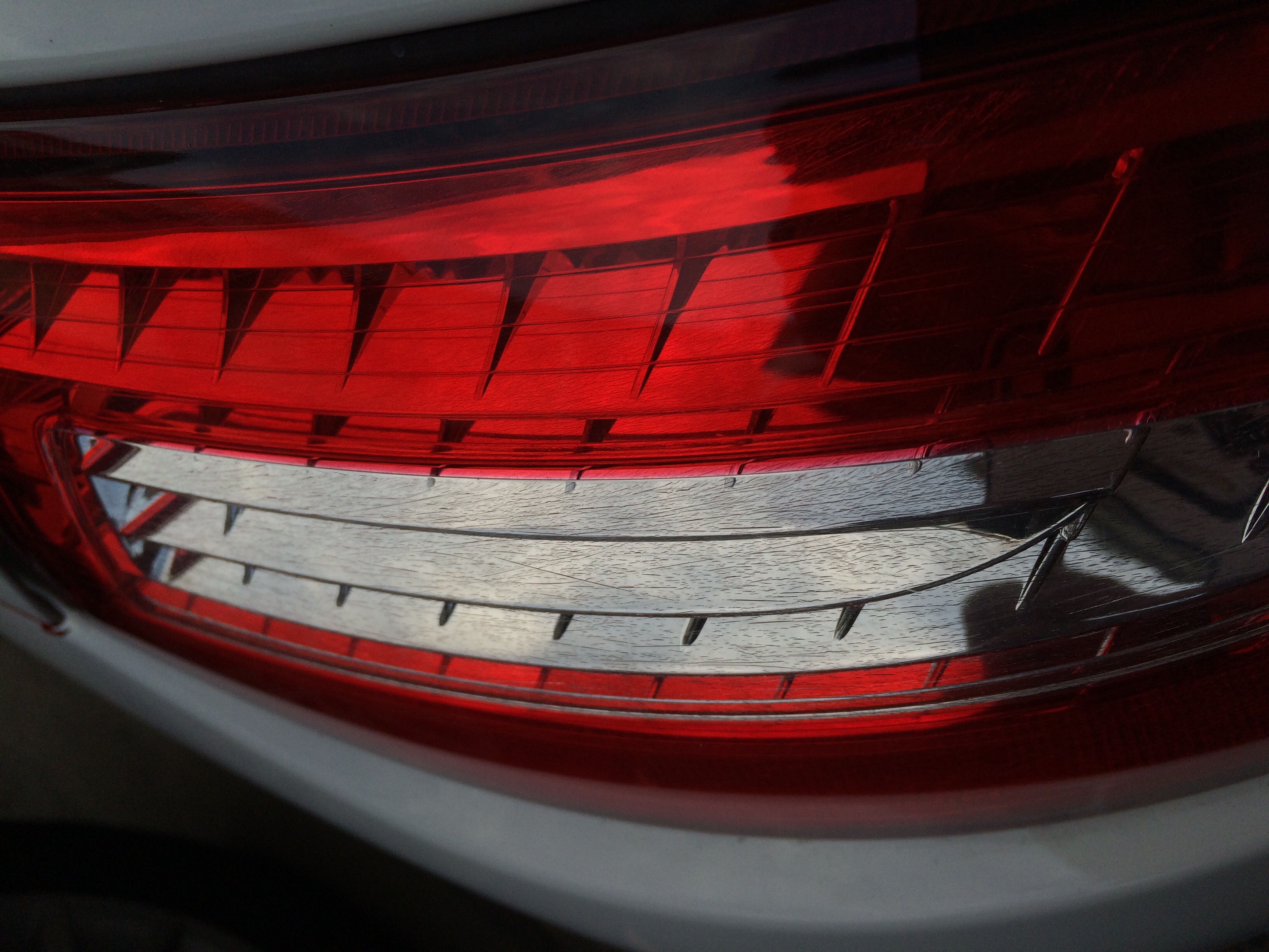

Honestly I don't know how it happened. Jh I don't think it's through washing otherwise the whole car should be in the same condition. The scratches are only on the lenses and they have similar formation on both side which is a mystery to me. Here are some pics

Both lenses have same formations which are more pronounced on the edge by the engine hood and almost non existent on the edges towards the pointed portion by the rear fender. The scratches are so hairline that if you run your fingernails it seems that there are no scratches and you wonder if it's inside the lens. It outside and using novus plastic polish set helped a bit but still there. Question really is how it happened. Have been very careful with the lenses except that I made a mistake not putting plastic on it early on.

One should never buff head lamp lenses. They are made from polycarbonate which has terrible chemical resistance. They are, therefore, "hard coated". This coating process protects the material from washer fluid and other fluids. If you buff and remove the coating the lenses will eventually turn yellow and craze/crack. Polycarbonate is used in headlamp lenses to meet pedestrian impact standards. Tailamps, however, do not need t meet this standard as cars are generally going slowly when backing. Those lenses are typically made from acrylic resin and will shatter when impacted but are not hard coated as the resin has better UV resistance. However, all amorphous ( clear) plastics have poor chemical resistance and will crack/craze before you eyes ( in seconds) if exposed to isopropanol. Do not ever let that alcohol near your car. I am not sure, but the pictures look to me like environmental stress cracking, typically caused by molded-in stresses combined with exposure to sun and/or chemicals ( alcohol, brake fluid, other ).

Hi Fah, can't decipher how it happened, they don't look like scratches coming from dory rag cleaning which I can say never happened. Stress cracking?... Hmm it seems that the novus system jh suggested lessened the scratches a bit which leads me to believe they Are on the outside seriously it so difficult to ascertain if they are actually inside or outside the lens. They really look bad? Any case of defective production that could still be warrantied? Long shot after 5 years of ownership....
