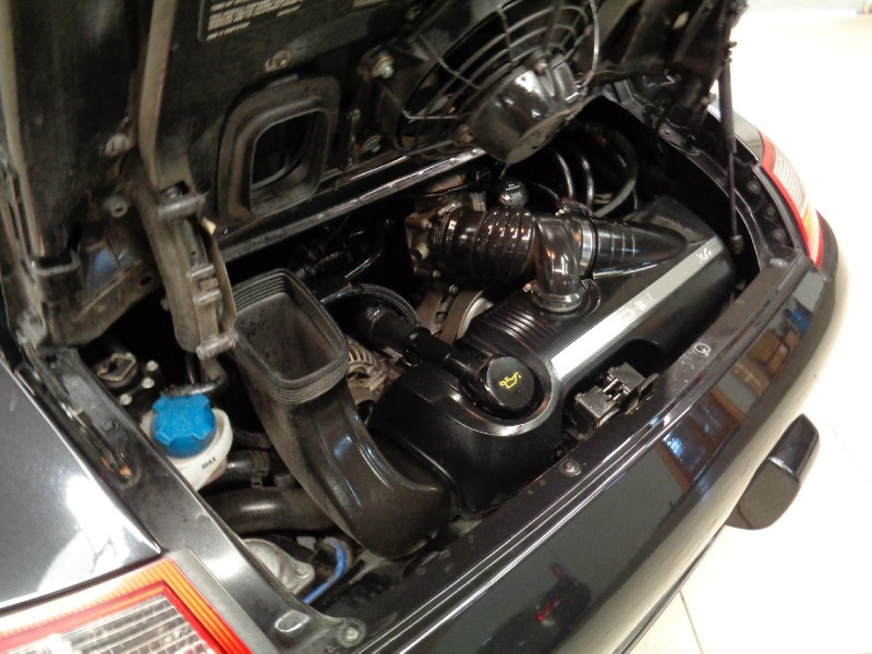

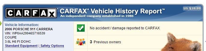

I'm thinking of buying a 997 & saw this car in the ad. It seems to look like a C4S with the big azz or (somebody did a very good job modified it.) When I check the VIN & carfax, it say nothing about C4S or 3.8L. Stupid question but is there such thing as a 3.6l C4S? The airbox in the pic look like it say 3.6L. I thought all S model are 3.8L. I just want to make sure before i pull the trigger.

It looks like a c2

C4S should have the dual exhausts

3.6 engine, rectangular tail pipes.....somebody glued an "S" on the back of a C4 or glued 4S on the back of a C2. Does look like a WB though. What color are the brake calipers? I bet they're black.

I think you're right about somebody sticking an "S" after the 4. After looking at the badge again & again. I'd noticed the spacing was off from side to side. Maybe it's a C4 not C4S.
yeah, it does look like the calipers are black.

+1 Carrera2

"S" is a 3.8L regardless whether a C2 or C4, red calipers, silver face gauges, quad exhaust tips, bigger brakes etc.
C4 is wider too

Here is the build sheet for the car. Clearly a Carrera 4 (and not a 4S).

See this thread: http://rennlist.com/forums/997-forum...n-decoder.html. Copy the link provided and insert the VIN desired. You can cancel the Print window that pops up if you don't actually want the printout... the web page with the info I copied and pasted should remain in place.
