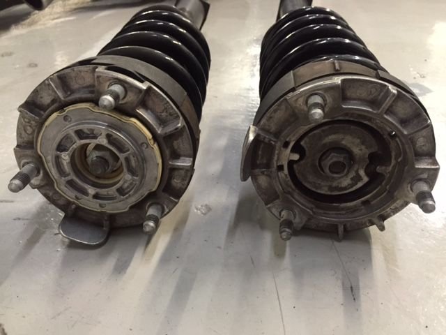

Both shocks were leaking and the passenger rear shock was missing the top mount insert, not only that, the nut that holds down the spring was loose.
A complete disaster.
That is pretty scary. Was the missing piece from the same side where the quarter panel was painted?

Yes, same side. Most likely happened at the body shop.
