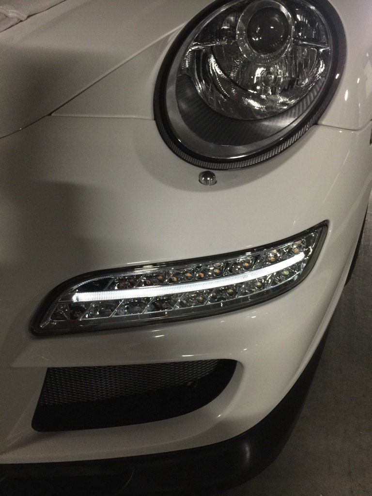

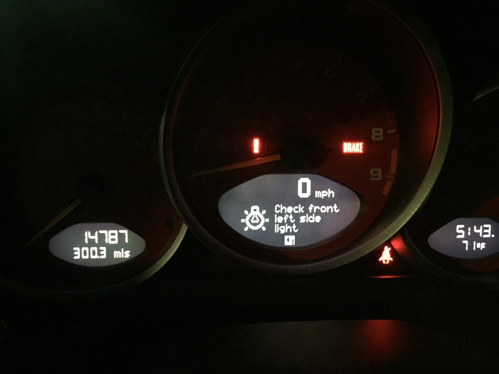

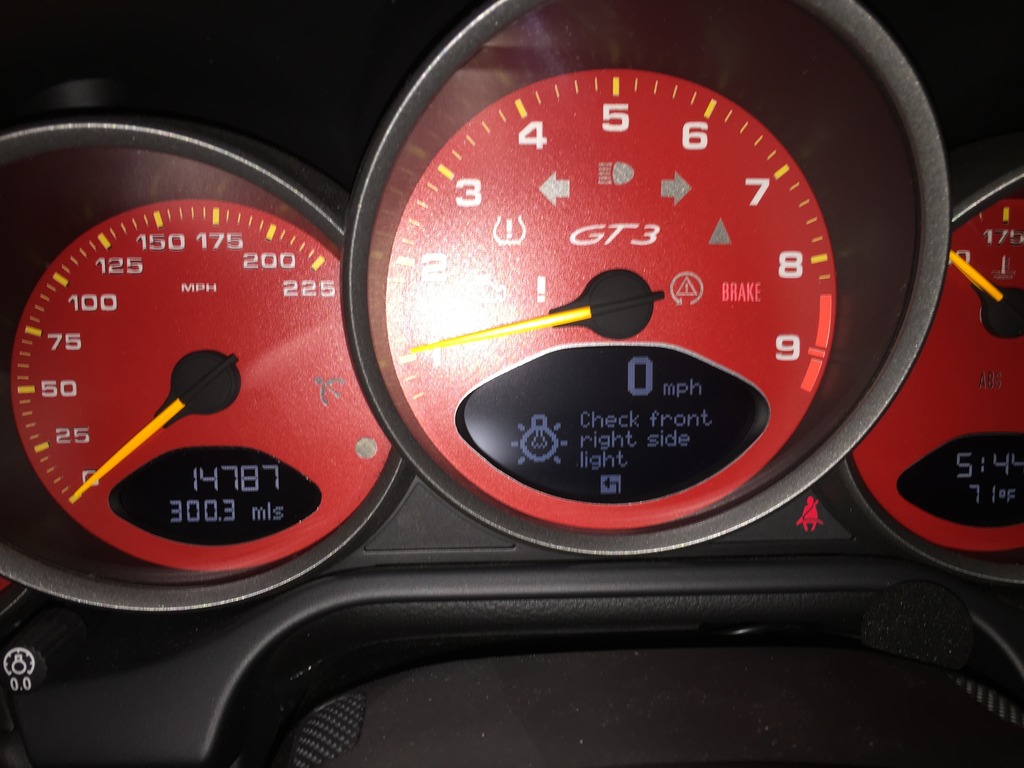

I installed a set of LED DRL's from eBay's seller Fishcake321 which is a reputable seller. I installed the lights per the installation guides from this forum and I'm stumped. From the troubleshooting that I've done, the wrap around DRL light bar is throwing the Check Front Side Left and Right Light warning on my dash.
I pulled the lights out and plugged the OEM bulb into the socket and boom the warning is gone. The seller said there isn't a need to add a resistor to the light.
Has this happened to somebody else?
