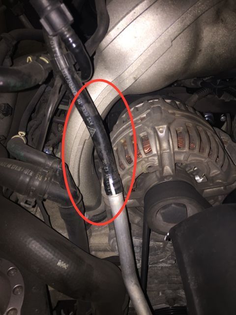

Hi all,
I need some help in identifying the part name / number in the photo. It's right behind the "snorkel" tube of the air intake box. This plastic pipe is harden to a point where the tip is about the break. So I'd like to replace it asap.
Thanks!

My guess is it carries AC refrigerant.

this hose carry brake vacuum from the engine's vacuum pump towards the booster
Originally Posted by simoncpw
Hi all,
Sorry don't have the parts no. right now but I can get it from pet tomorrow if you need it.its normally rerfered to as'brake vacuum hose located behind the airbox'sorry for bad english
Thanks!
No need to say it is a very important hose because when it breaks,the vacuum for braking effect decreases and so its dangerous to drive on.replace this hose asap

Thanks for the advice. Found the afternoon. Will be replacing it this weekend (temporary put a pipe-clip-lock to prevent it from breaking further).
EDIT: Replaced ;-)
