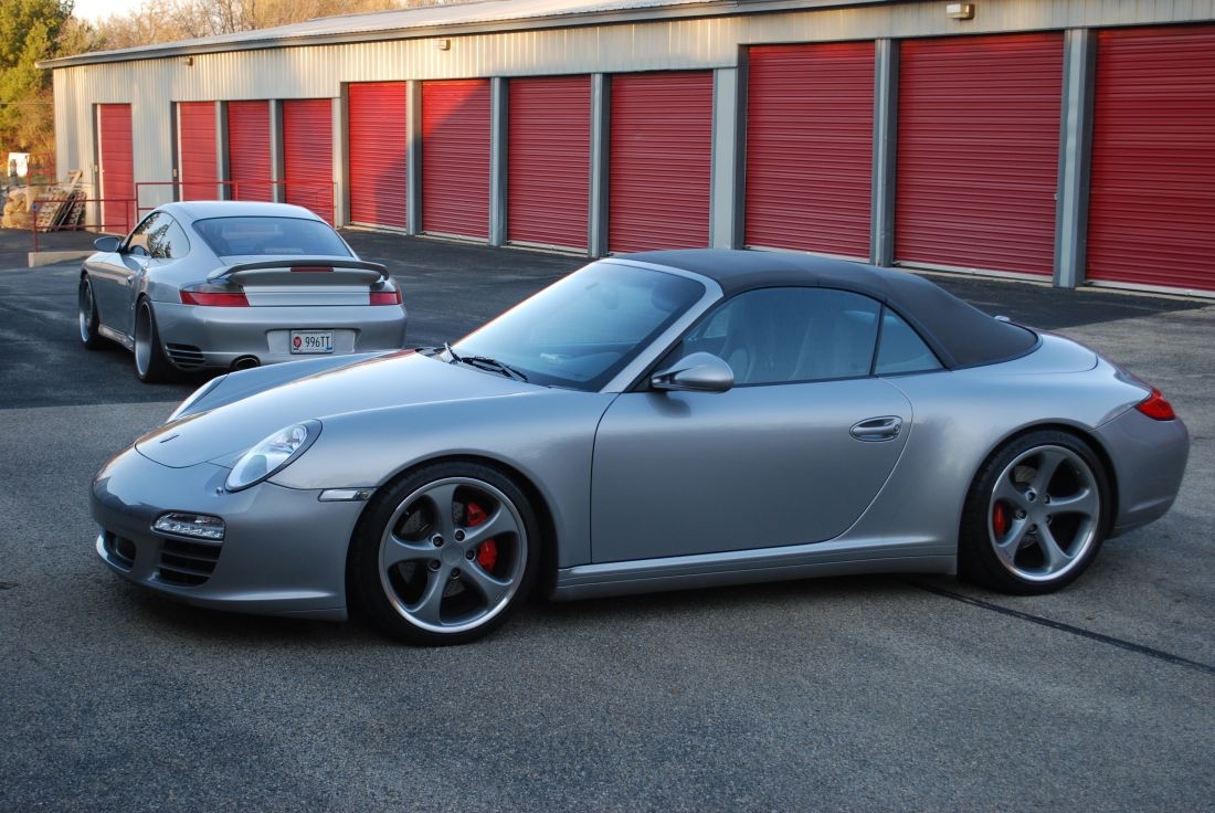

Plugs have already been mentioned......check condition of serpentine belt.....I carry spare because we travel in that car. The 09 C4S is my wife's car and at 60K has been incredible.
About to put on winter fitments plus hard top and drive for the 7th WI winter. Good Luck.
