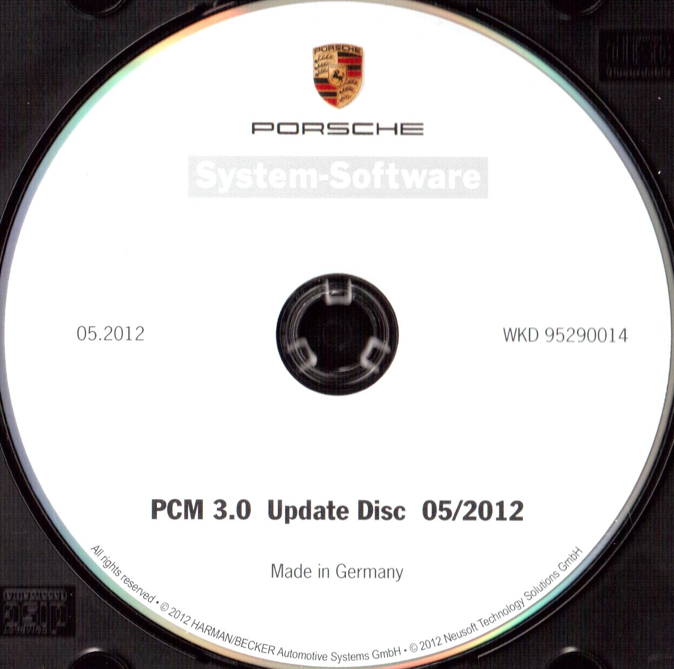

why? because disks with updates is workshop tool. so you cant buy them. but I think non-official services with very good relations with dealers can have them.

I've heard dealers charge a full hour of labor, but it's actually a fairly trivial procedure. I updated the maps on my prior Porsche and it only took a few minutes. Insert disc 1 in the frunk wait for it to say load disc 2, insert disc 2 wait a couple minutes and done. If you can work a cd or DVD player, you may have the skills it takes. The Porsche service department guy even offered to sell me the maps at cost because he thought the asking price was a joke and no one else was buying.

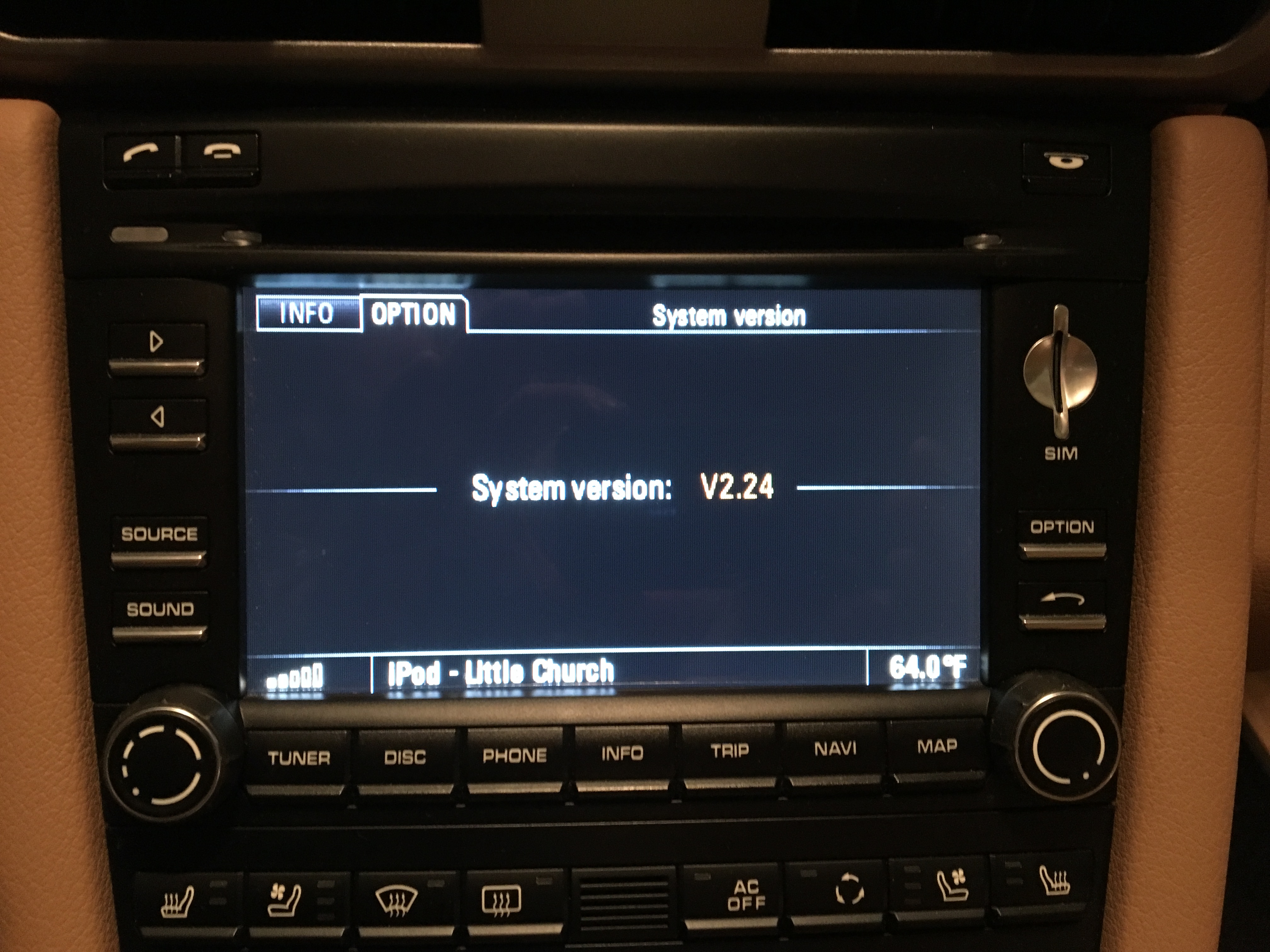

I finally got the latest maps I bought from Suncoast installed. FWIW, for the 997.2 cars with PCM3, there's no way to DIY this that I know of - it requires installation and coding at a dealer. There's no place to load them in the frunk and while the PCM disc slot may work, there's still the process of coding that needs to happen. Cost was 1 hour labor @ $135 less 10% PCA discount.

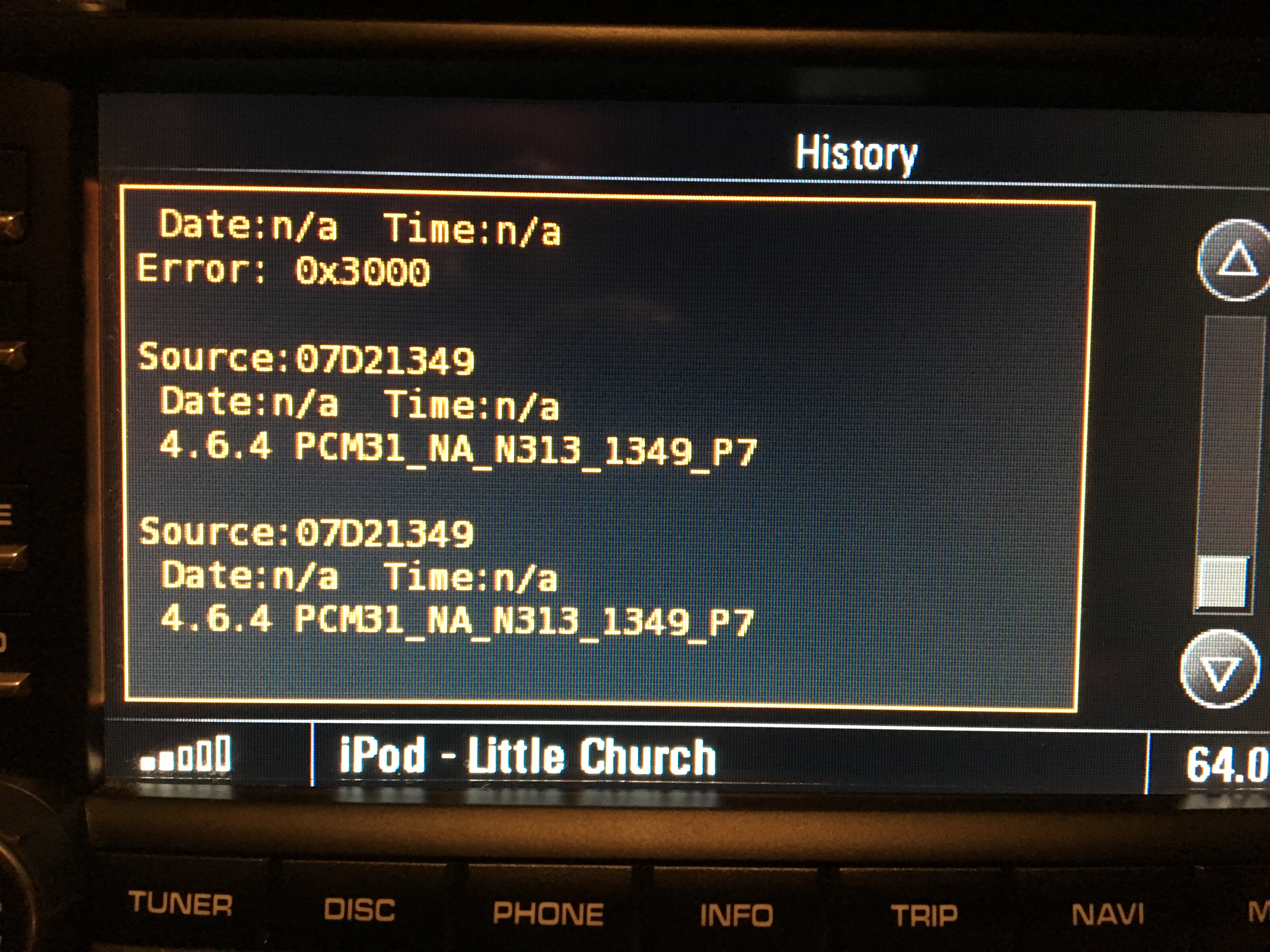

My PCM now shows System Version: V2.24 under the Info/Option menu. There's also another way to look at software update History by selecting Source/Info buttons at the same time - not sure it is that informative...

I have had no issues with the iPhone 6s so far. Well, other than that when I got the car back, it was like a new PCM - phone was not there, no NAV addresses, personal settings gone, Sound settings back to defaults - that was a surprise.
