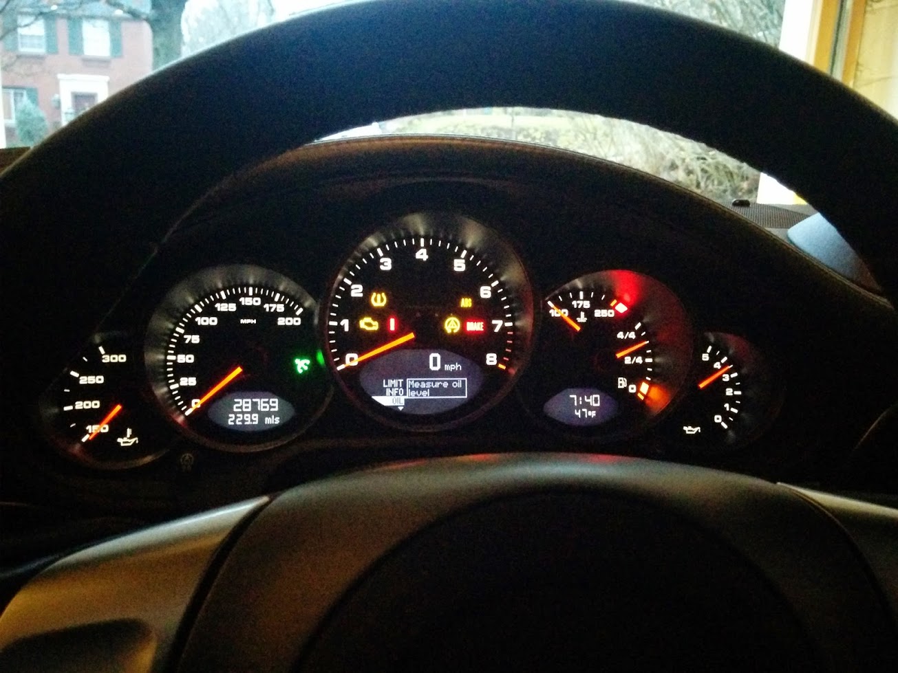

Been using Motul 5-40 for years. Last change was done w X-Cess, not X-Clean as I seem to recall. Immediately noted high oil pressure, gauge remaining pegged even warm at idle. Was going to change out gauge when I noticed a similar post by fellow user.
Today after about 1000 miles I changed oil and used Mobil 0-40 on a hunch. Oil pressures returned to normal, 5 at startup, 1.5 warm idle, 3-5 on road at rpms. I don't know what this says about Motul XCess or rest of line but I am concerned about effect of excessive oil pressure over time, especially with OEM setup bypassing filter under certain conditions.
Any thoughts?

If you're ever concerned about the oil gauge reading wrong, turn the car on to accessory mode, don't let the engine turn over. If the gauge reads anything other than zero, the oil pressure sending unit most likely needs to be replaced. Sometimes you can just clean the contacts but that doesn't always work or might only work partially.

Did this last night. In "off" the needle is at the bottom of the 0 line. In Acc the needle displaces slightly just to the top of same line, maybe +.05 to .1 (one tenth). Is there some minimal pressure in system or would you read this as a 'fail' for the sensor?

There is no residual oil pressure after the engine has been off a short time (on the scale of seconds).
I recently (easily) replaced the oil pressure sender on my 2005 C2S. I was alerted to its failure with the "off" test described above and the abnormal unexplained variation in oil pressures while the engine was at various RPMs.

OK. On cold motor with motor off, key in right click position I am now seeing a +1 reading on the op gauge. I guess this is the indication of sensor failure. While in general I am not a believer of coincidence I have to think that initial 'problem' and subsequent 'cure' has nothing to do with brand of oil. I will swap out sensor and go back to Motul to see if this holds true. But not for a while. Just laid out 1200$ for coilpacks, plugs, service and need a break.

OP tested the oil pressure sending unit while the car was off and it registered pressure. Now supposedly it doesn't. Whether there's no oil, too much oil, or mixed oil, that sending unit should still read zero. My guess is his sending unit is on the way out or the contact is poor and being affected by seasonal changes.
Before I had mine replaced, my readings changes depending on temperature, relative humidity, and even me just playing with the contacts. Taking them off and cleaning them resulted in a lower reading but not a perfect reading.
