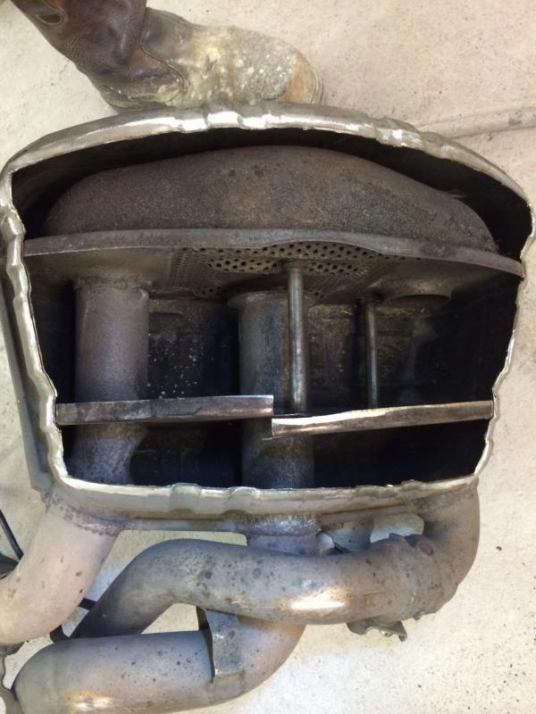

OP: It sounds like you are making the right call. As far as horsepower goes I've never been able to "feel" the difference with the x-pipe, crossover, or intake... but I never dynoed it either. If there are gains they must be very modest. It is important to note that in general whenever you reduce restriction in the exhaust, you lose low-end torque but you gain high-end horsepower. If you are frequently running to redline then theoretically lower restriction gives you a gain. If instead you tend to shift earlier (maybe in the 4-5k RPM range) then maybe not so much.
Originally Posted by cerbomark
Gundo, being that you are here can you answer if the Hack and the PSE are the exact same other than the on/off function? Thanks!!
Just FYI: Quite a while ago some guy had a thread on how to fix a rattling PSE. He included photos including one of the interior. I grabbed a copy just for the heck of it in case I ever wanted to refer to it. So here it is! Note that this is the pre-fix photo with a notable split in the cross support.
Even slight changes can have significant effects on acoustics. This has been discussed in various threads where different folks use different diameter cross-pipes for their Gundo mods or Fister; even a half inch seemed to make a big difference. In the photo you can see that in the PSE muffler the third pipe is not a simple cross-over like the Gundo but gets it flow from inside the can itself before it goes through the "mesh" that the normal flow goes through... so it does had some chance to resonate in the muffler can. Granted that the sound still ends up being strikingly similar. I am only saying that there is a difference and I could easily hear it when I compared my 997.1 Gundo to a 997.1 PSE while I had that car. Now which sounds better opens itself up to a whole different argument. And as for bang-for-the-buck the Gundo and Fister's implementation of it win hands-down.
