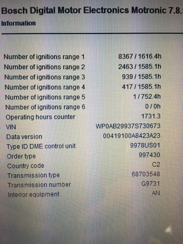

DME Report
Since I have had issues with smog...I pulled out my Durametric Cable and checked for faults.
Ran the rev report....I better be careful!!

Yea... you probably would have issues with passing smog in california with a tune that runs rich so it was a good idea to go back to stock to pass that. An aftermarket tune that was done well shouldn't give you problems, though...
As for the DME report - looks like a slight money shift, but after so many hours it probably didn't harm the engine if you're still running fine. The 1 ignition in range 5 might be a glitch. Nothing you can do about it now, just enjoy.
