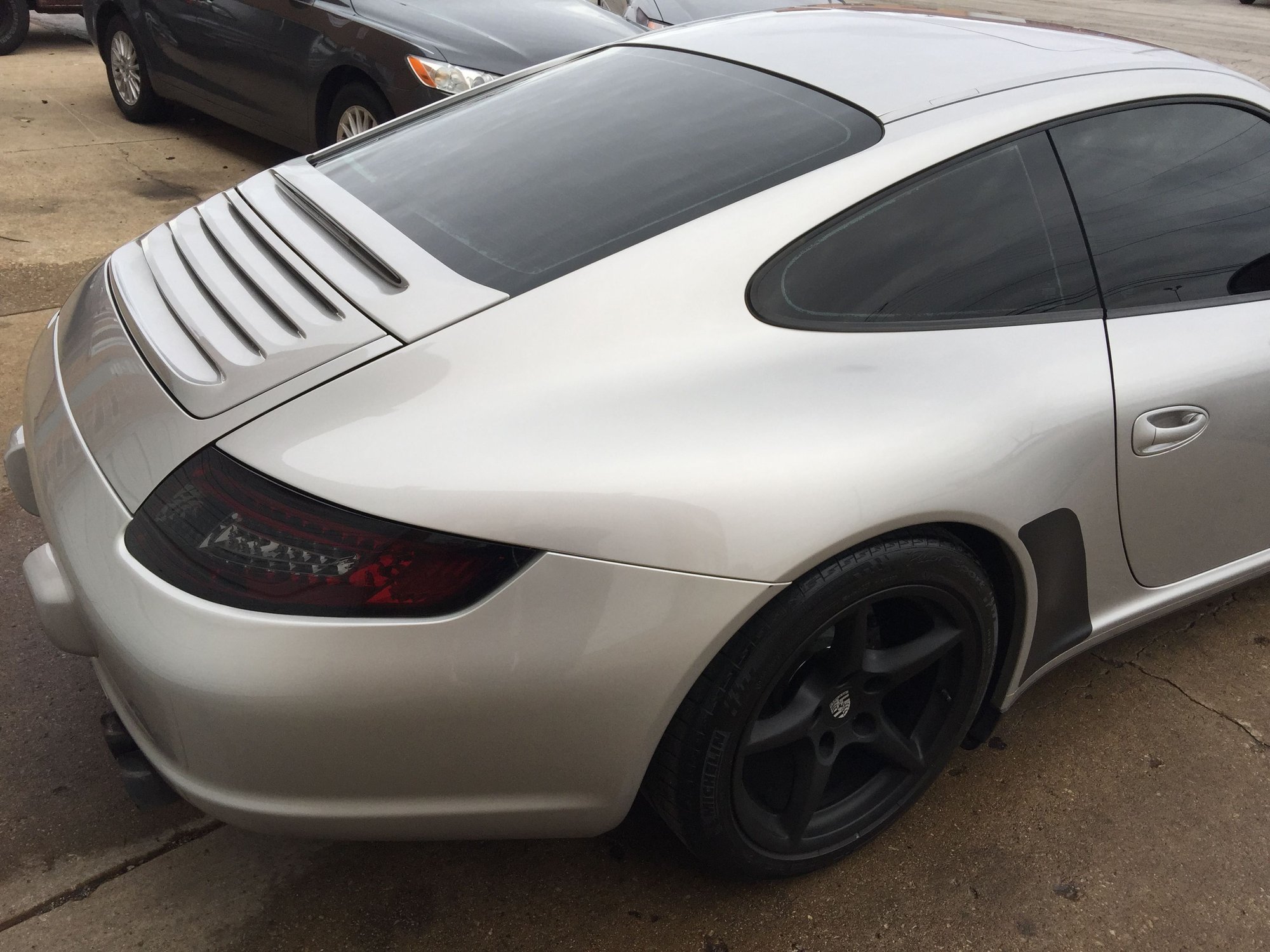

I have 12mm Front and 20mm rear the spacers came with new bolts it's perfect.
Stock Wheels

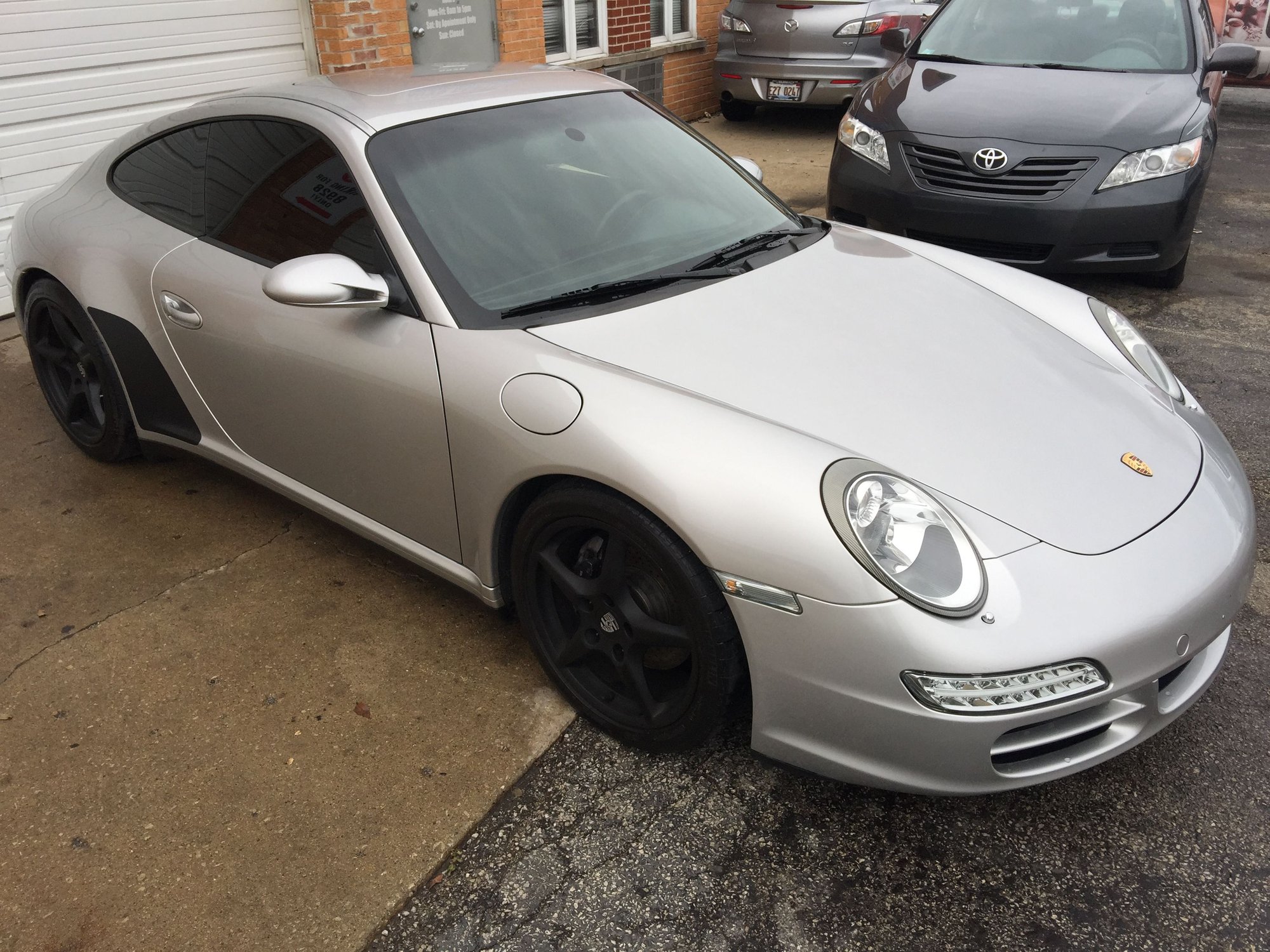

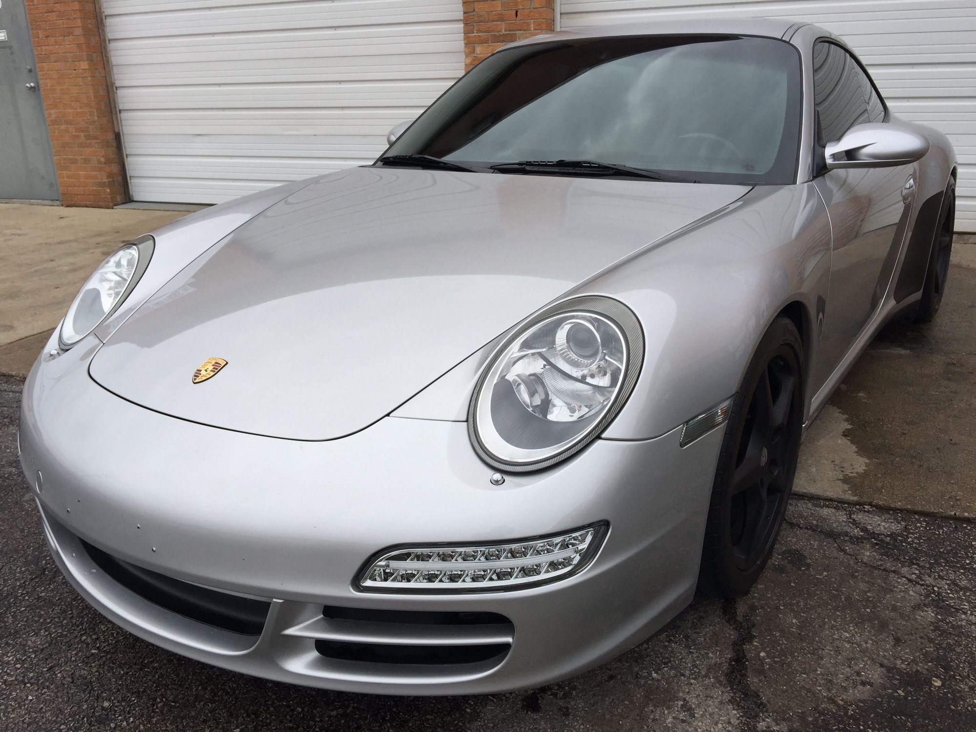

Szymon Kowalczyk's Avatar
Joined: Aug 2012
Posts: 94
Szymon Kowalczyk is infamous around these parts
Originally Posted by roelricardo
Do you have some pictures so I can see how does it looks??
Many thanks.
20mm rear
12 mm front

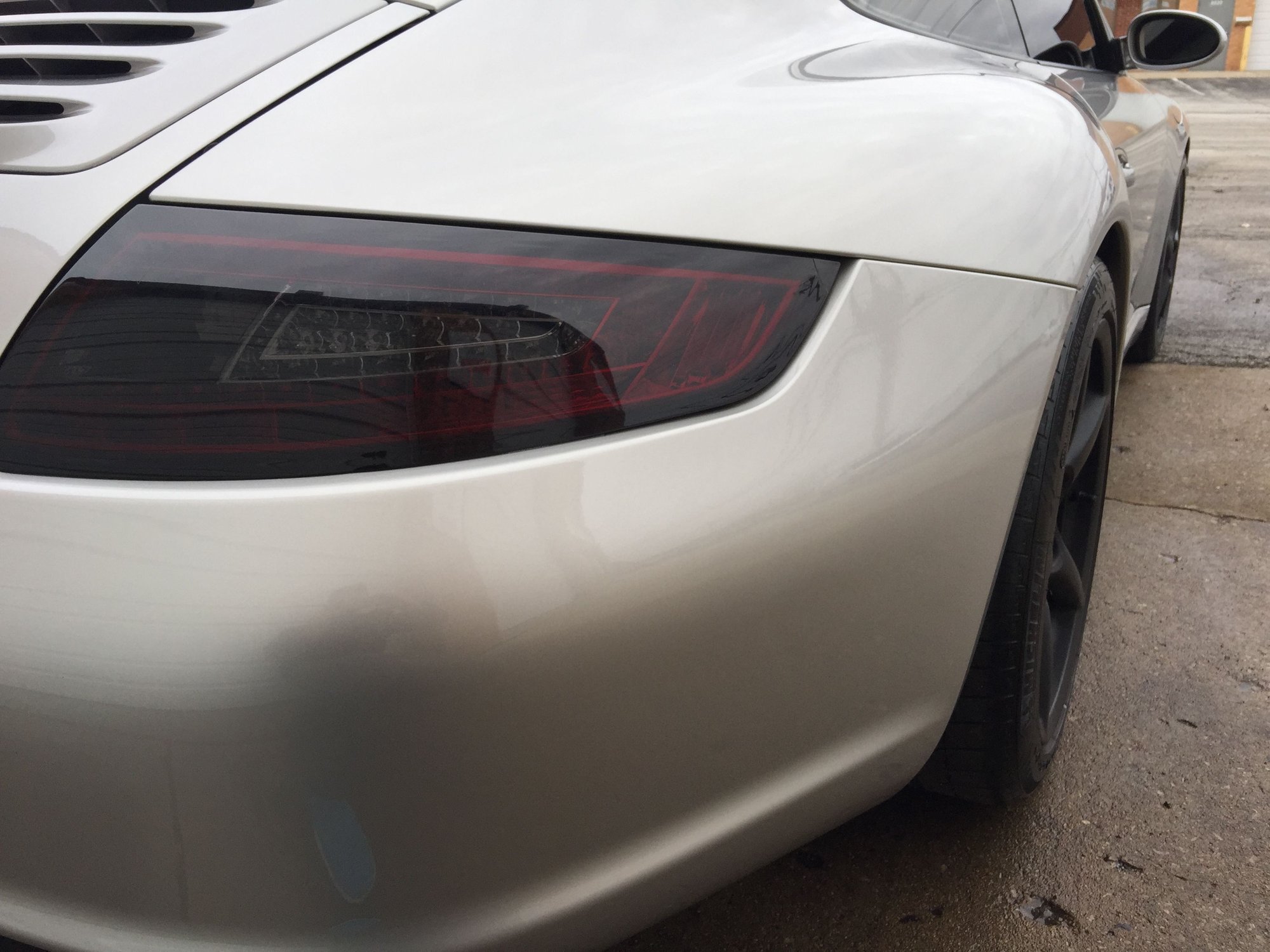

I can't tell if that's a widebody. Do you get stuff kicked up on the rear fenders due to the outboard position of the tires?
Looks GREAT btw.
Old Jan 20, 2016 | 07:33 PM
StormRune's Avatar
Joined: Apr 2013
Posts: 502
From: Austin, TX
Rep Power: 88
StormRune Is a GOD !StormRune Is a GOD !StormRune Is a GOD !StormRune Is a GOD !StormRune Is a GOD !StormRune Is a GOD !StormRune Is a GOD !StormRune Is a GOD !StormRune Is a GOD !StormRune Is a GOD !StormRune Is a GOD !
Looks GREAT btw.
Hint: You can tell it is a wide body since there is a visible ledge along the outside of the tail light in the first photo. This is there because the cars use the same tail lights but the 4's fender flares out further, effectively causing the outside of the tail light to be more inset. On non-4's the outer tail light edge is almost flush with the fender.

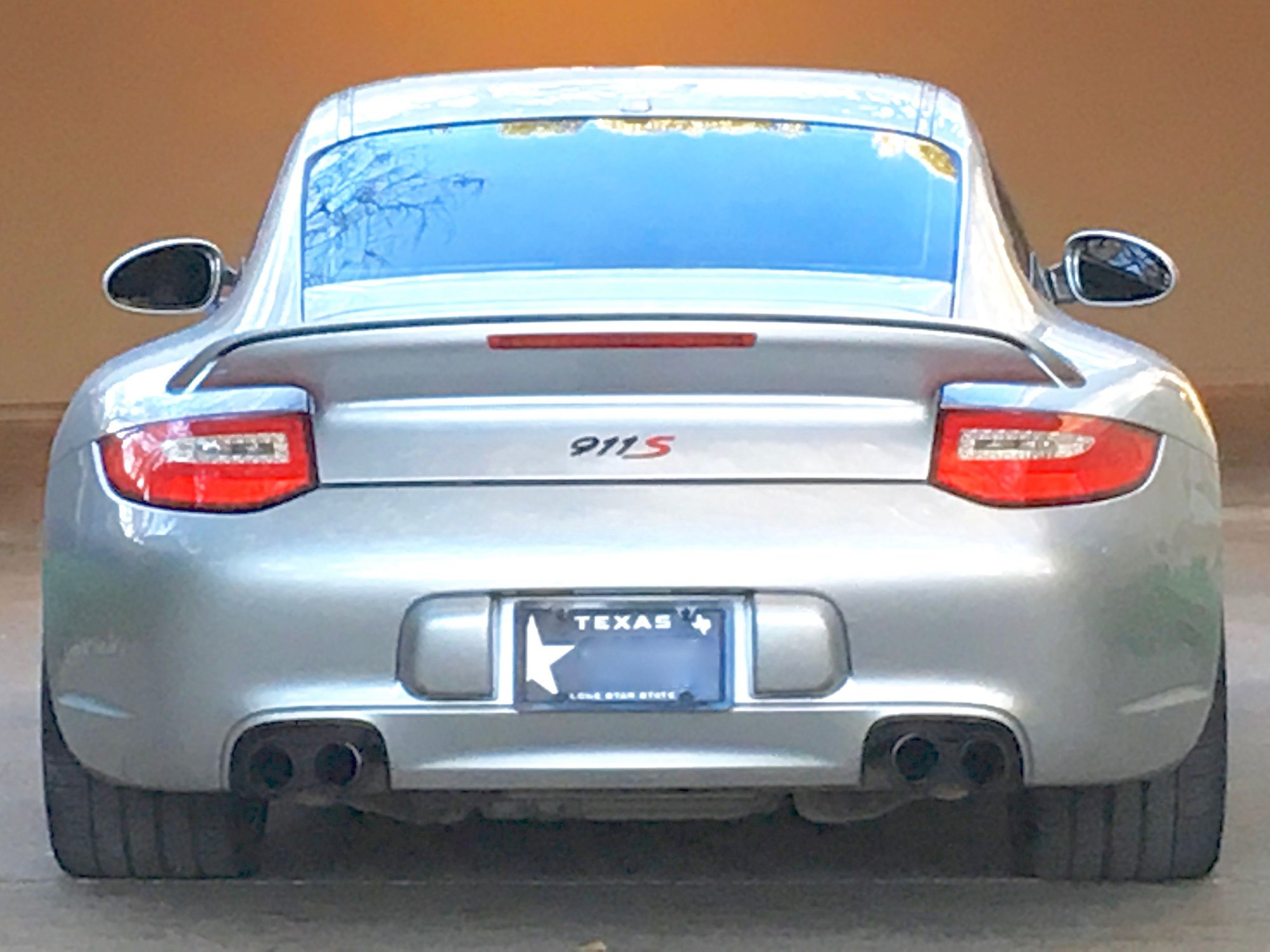

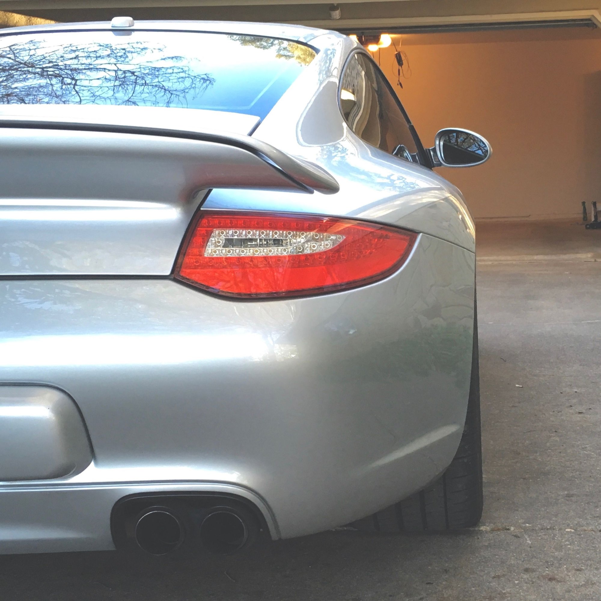

Using the method I described back in post #9, I installed my new spacers today. With my reduced rear camber to -1.4 degrees and wider 305 tires I only needed 5mm spacers to get the top of the tire flush with the fender now so I went ahead and just used official Porsche spacers. As expected the top outermost edge of the tire is now flush. Previously I was using 14mm spacers to get a flush alignment but with the new setup they were sticking out almost 10mm too far! (BTW, I'll be posting the prior 7mm/14mm spacer set for sale on the Rennlist classifieds tomorrow along with appropriately longer bolts).
The first photo is looking straight ahead from behind the car so that the camera angle is perfectly aligned with the front and rear edges of the fender. If the tire jutted out any you would see it here. The second is another photo front behind the center of the car showing that the stance looks good and the tires don't feel too far out.
