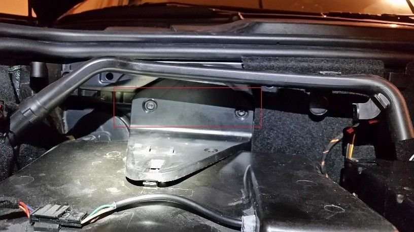

Anyone know how to remove the bracket that holds the Vapor Canister in place? It appears the instructions are for the C2 and not a C4. I cannot find any screws that hold the Bracket in place. They seem to be behind the unit there is no way to get to them.

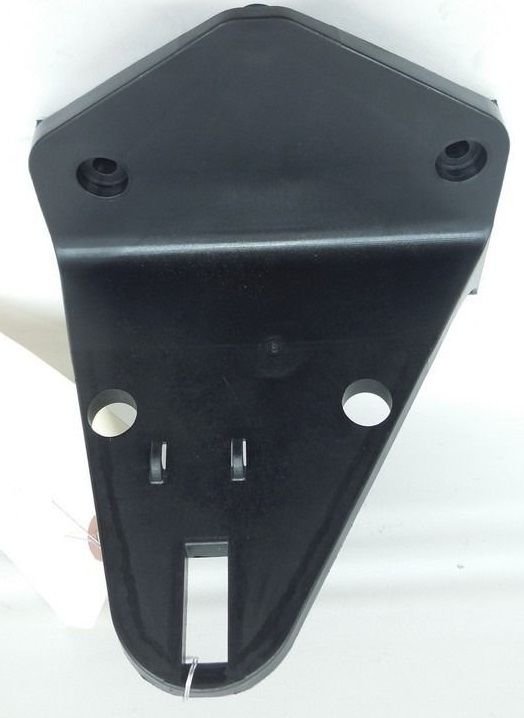

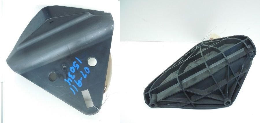

OK, more digging. The vapor canister itself is the same part number 997.201.221.03. 2WD models use a different bracket and vent line than the 4WD models.
The 2WD bracket looks like this, notice the two screw holds on the top just like in the workshop manual:
The 4WD bracket looks like this. Notice the lack of screw holes on the front, but two on the back. The third spot is the catch that prys off with a trim bar. So the mounting screws are on the backside. Access is probably from the battery compartment side. Not sure if you need to remove the battery to get to them or not.

That last Bracket looks like mine, but there are no Screws on the backside of the wall near the Battery. I can see in there and I do not see how or where I can access the screws holding the bracket. Below are pics...not my car though.....

Odd, try removing the lid to the canister. There are clips along all the sides. The bracket is not attached at the top of the lid, it just sits in those holes. You should be able to bend the bracket just enough to slide the lid off.
Once off see if there are any screws behind the canister. PET calls out qty 2 M6x25 screws for 2WD, and qty 2 M8x18 screws for 4WD. But I've seen areas where PET has been wrong before (TPMS antenna mounting brackets for example).

Im not sure that will work since I cannot get to the Clip on the backside.
