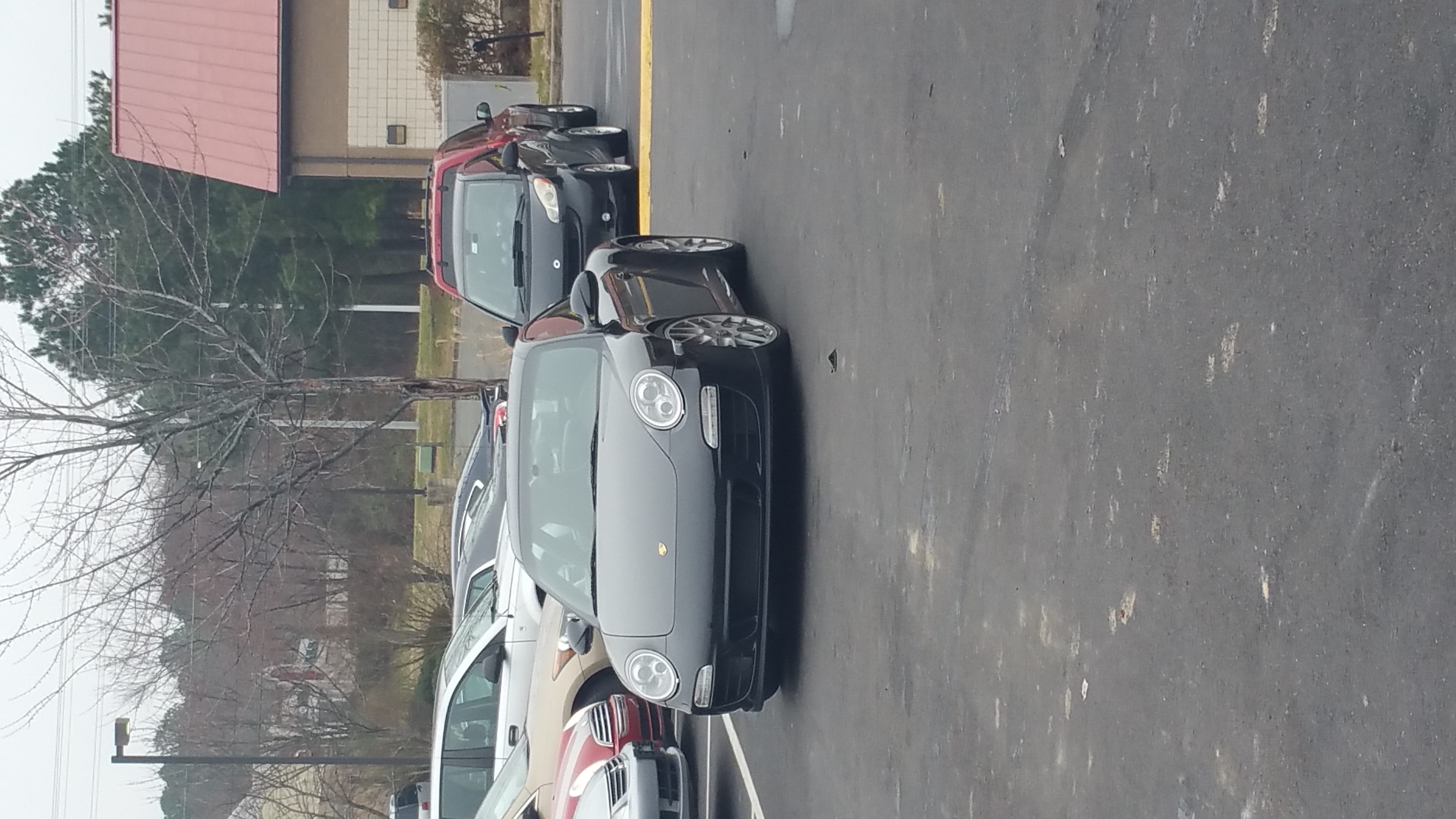

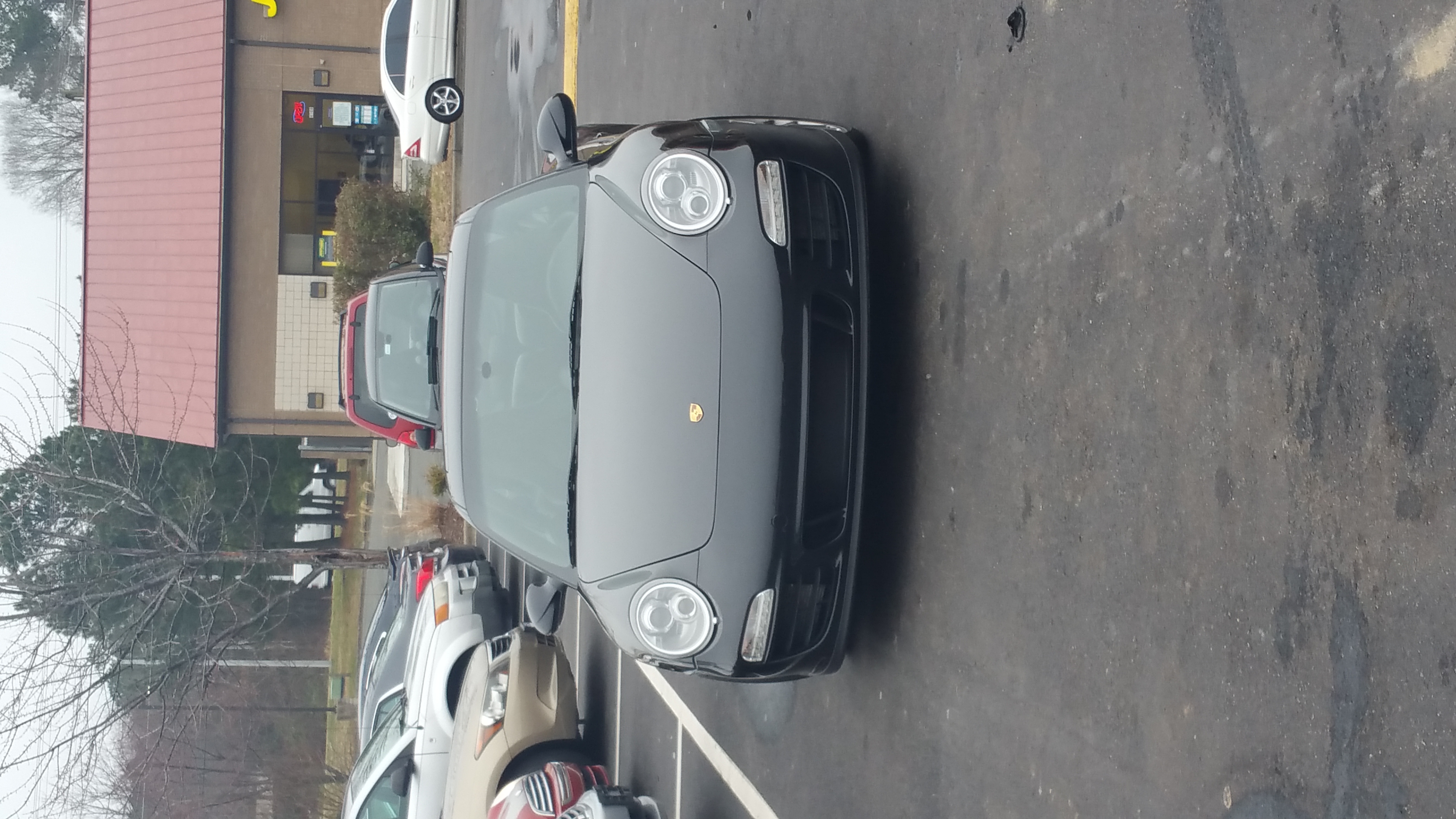

I must agree
Originally Posted by myw
exactly.... the rad shrouds have to be the exact size/fit to match the bumper entrances themselves.
LOL
with all this said, the oem gts front end (while technically isn't that different then the standard 997.2 bumper) is the nicest looking one. if i could do it again i would have gone that route.
ID:	441034   Click image for larger version
