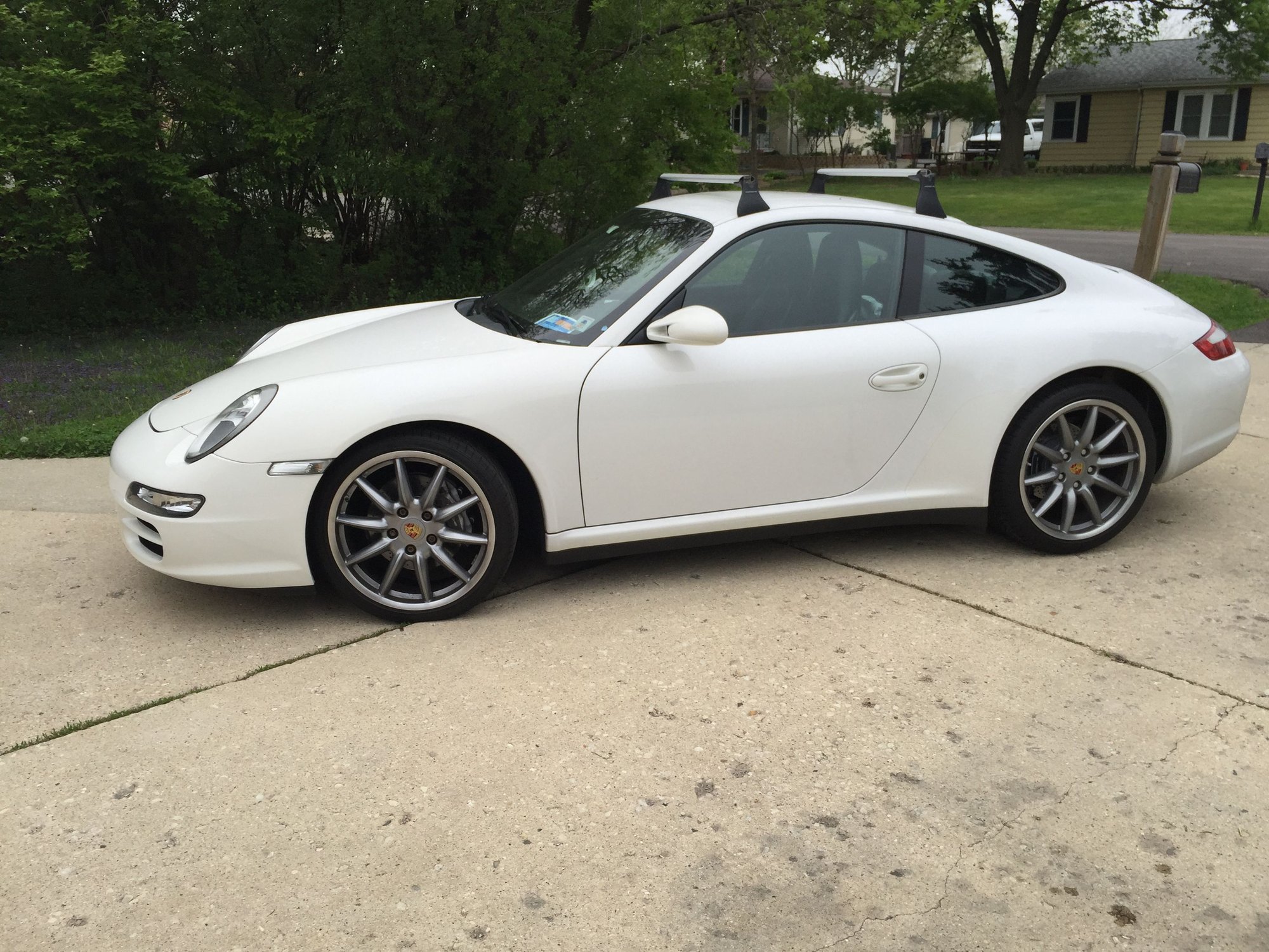

Hi - anybody got the Porsche roof transport system?
I just bought one on ebay and fitted it - and after 30MPH it whistles like crazy...
I didn't have the black rubber covers on so it was perhaps that - anybody else have a similar experience?

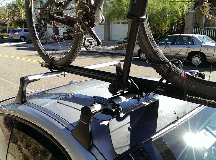

I use a wind fairing with my rack. It's very quiet; you really can't tell anything is up there.

Andy, mind giving details on your fairing? Looks like the perfect things.
Old May 14, 2016 | 08:58 PM
nwGTS's Avatar
Joined: Mar 2015
Posts: 121
From: Chicago
Rep Power: 37
nwGTS has a reputation beyond reputenwGTS has a reputation beyond reputenwGTS has a reputation beyond reputenwGTS has a reputation beyond reputenwGTS has a reputation beyond reputenwGTS has a reputation beyond reputenwGTS has a reputation beyond reputenwGTS has a reputation beyond reputenwGTS has a reputation beyond reputenwGTS has a reputation beyond reputenwGTS has a reputation beyond repute
Pretty sure it's this one:
Inno Medium Universal Mount Faring for Mid-Size Cars and SUV's https://www.amazon.com/dp/B002V35PWM..._Qw-nxbF9R47WP
Correct! I wasn't sure of the exact model because I bought my roof bars used and the seller included the fairing but didn't say what kind it was. Definitely recommended.

Do you feel comfortable that the vinyl protective pad is sufficient to prevent scuffing of paint?
Old May 15, 2016 | 07:21 PM
andy92782's Avatar
Joined: Oct 2014
Posts: 31
From: OC, CA
Rep Power: 13
andy92782 is infamous around these parts
I haven't noticed any scratches. I'm also not as **** as others when it comes to waxing/polishing/correcting/etc. YMMV.
