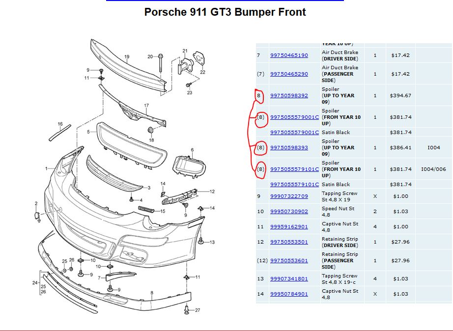

Does any know the part number for the GT3 rubber lip?

here's the OEM GT3 lip part#. You can also find them on ebay for cheap & made out of poly.

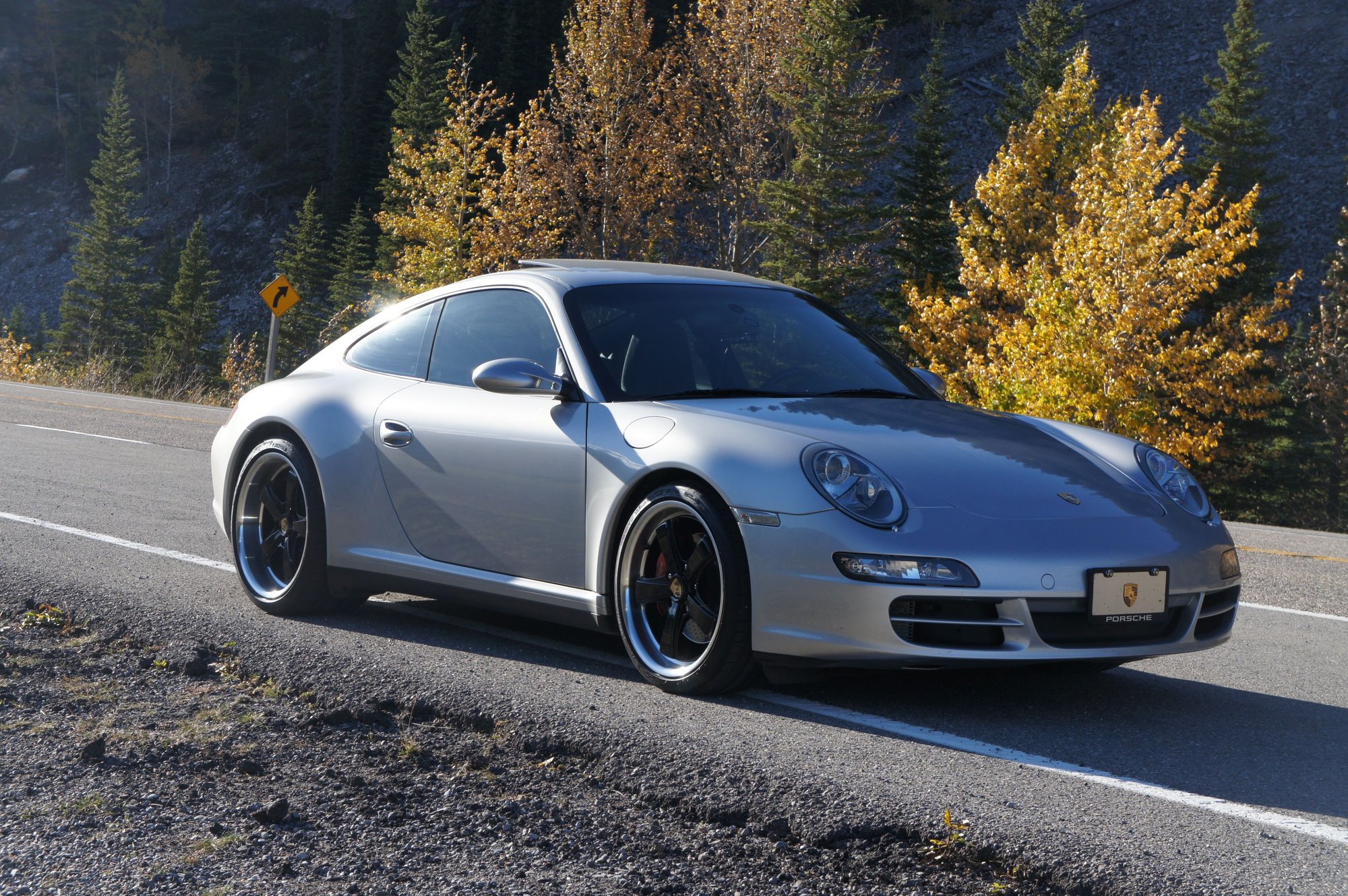

I happily added the aero kit from Suncoast last year, and everything needed to do the transformation was included. I chose to paint the bottom lip black as my rocker panels are black, and my body shop used a thick rubberized paint to reduce the likelihood of chipping. So far so good.
Here is the before:

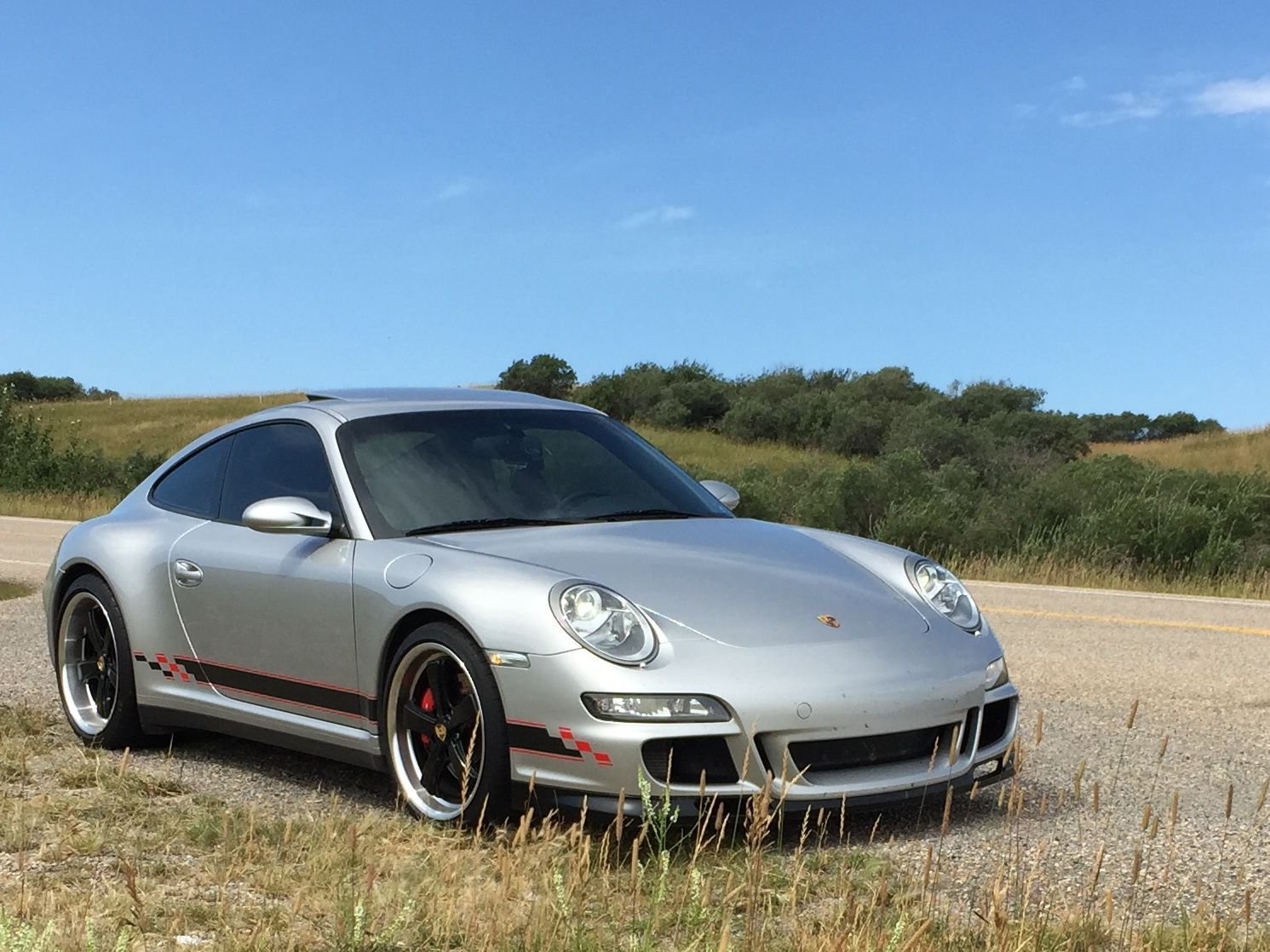

And the after:

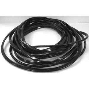

For maintenance, I purchased through Amazon 50' of inexpensive door edge molding that applies perfectly to the bottom of the lip.
Every month last year I would replace it with a new section, and the bottom of the original was saved from curb rash!
Love the aero kit front, and feel it gives the car a much more agressive look.
