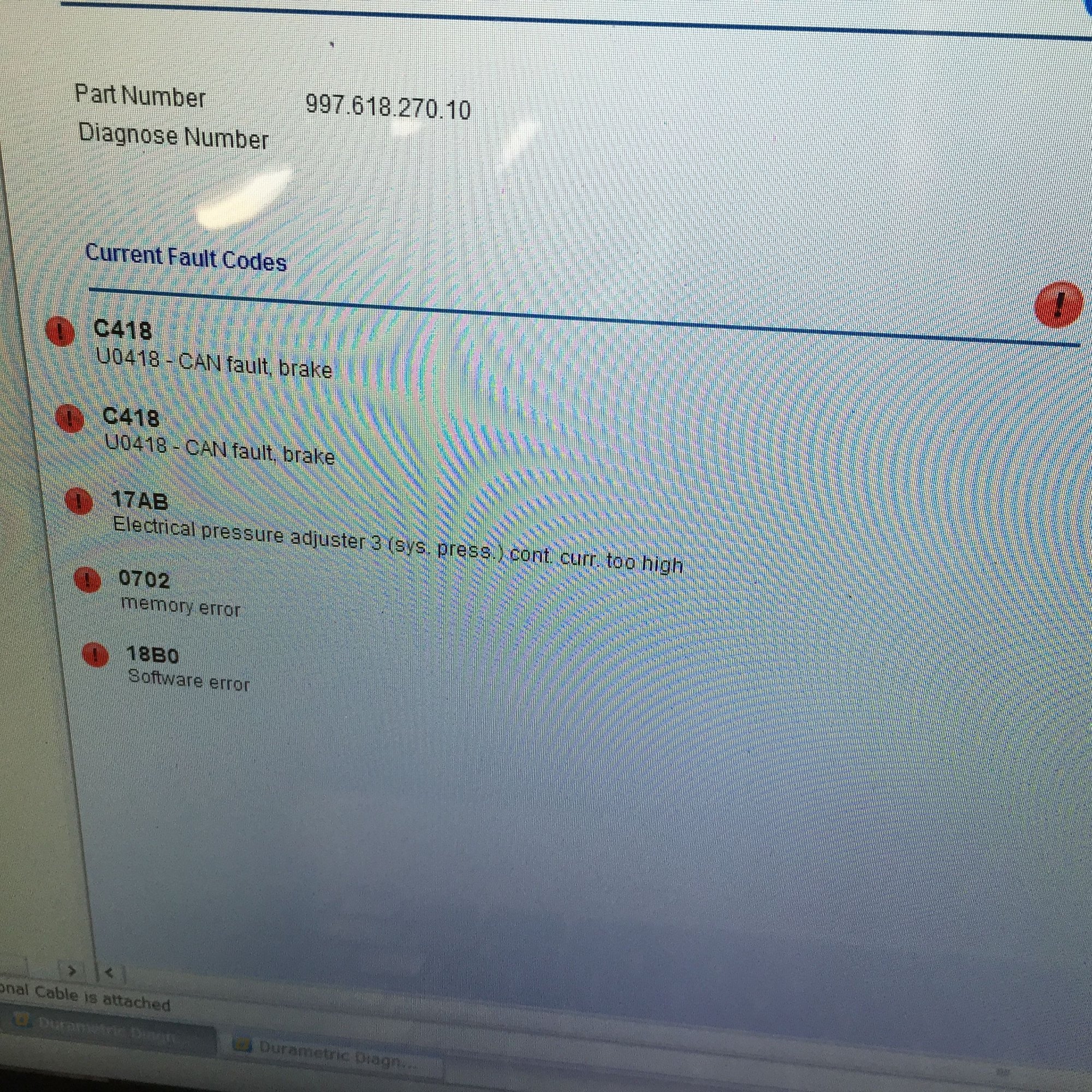

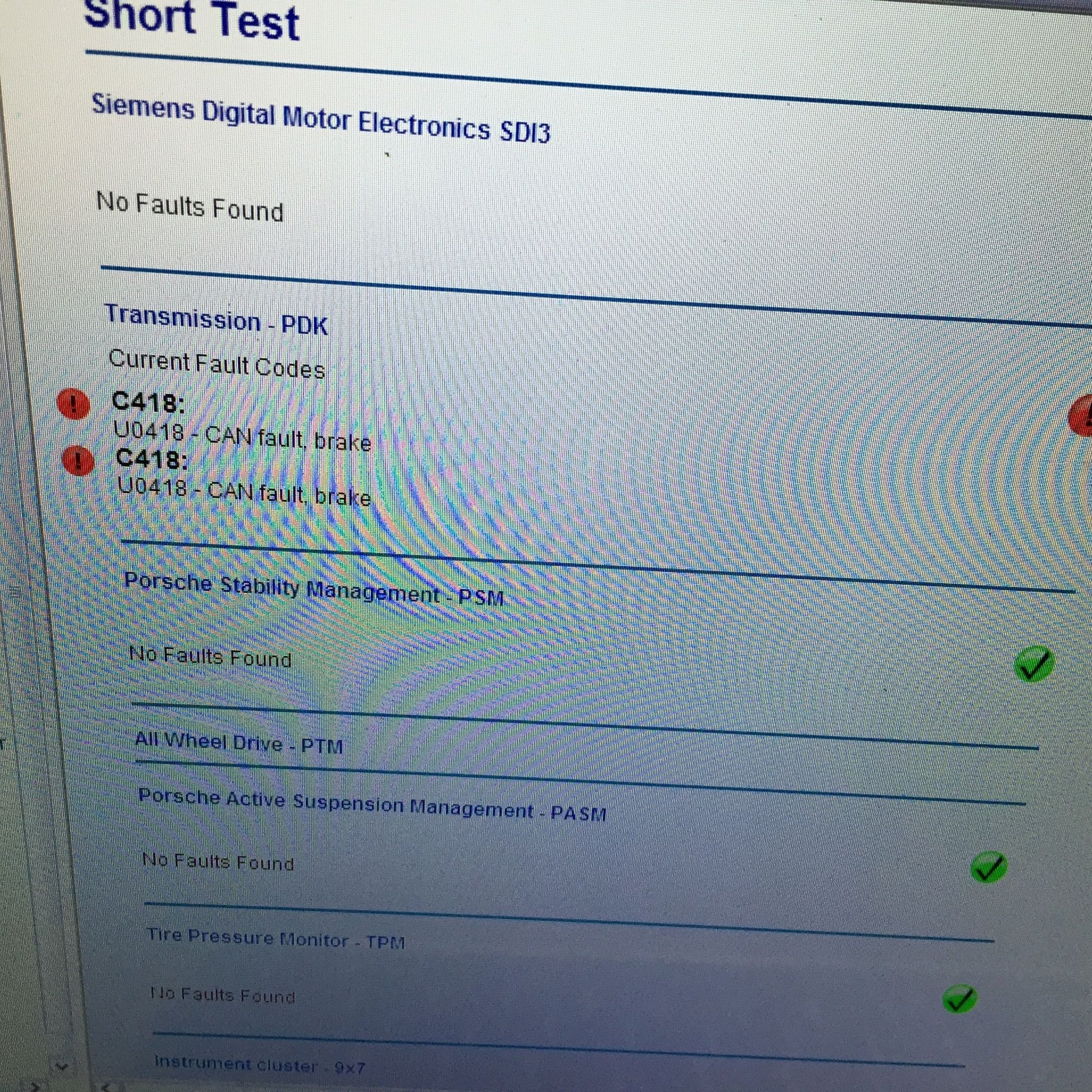

We scanned the car. The following codes were registered in the computer.
We reset all the codes, turn off/ on the car; re scared and got this.
Did it again and the final error codes an the PDK are:
The car has been driving well. Does any one knows what this codes stand for?? Any critical message, Critical PDK malfunction? $$$$

Just in case. check your battery and make sure is ok. These cars are highly electrical dependent. Any variation in electrical signal can cause all sorts of code and malfunctioning. Good luck!
