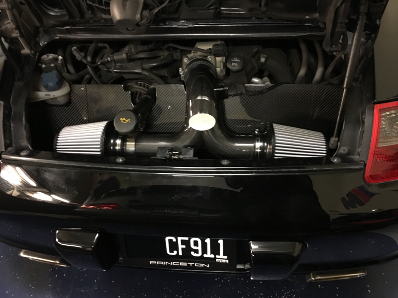

I love mine, sound is amazing. I will be putting it on the Dyno to see if there was really any gains

They sound great but... not a true CAI by a long shot.And the price $$$!

Lol lose of filtration. No offense but those air two large air filters on the end of each tube. I also hear people say it will suck in hot engine air. I don't buy it. When you close the engine lid there can't be more than a 1-2 inch gap between the heat shield and the lid. It would be pretty easy to get a reading of air temp that is passing by the mas. When I get it on the dyno I'll post results. Main reason for gains for this intake is how restrictive the factore 997.1 air box is. Don't think it will make 19 more whp like fabspeed states but I could see at least 10 maybe.

Get to that dyno and let's see!
