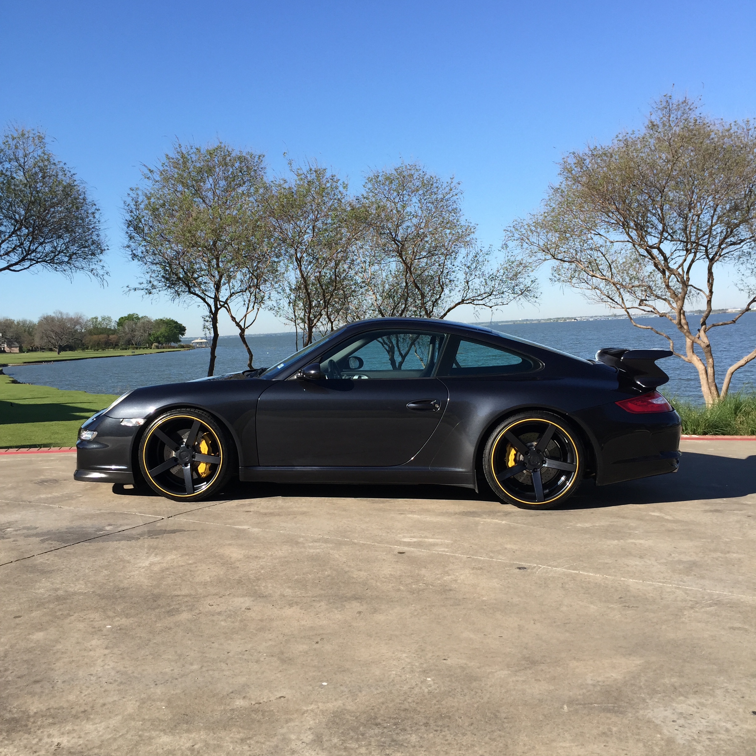

yep scraping is inevitable but front lip is a consumable item. Mine is lowered with Eibach springs.
Even with 20" wheels, it looks good.

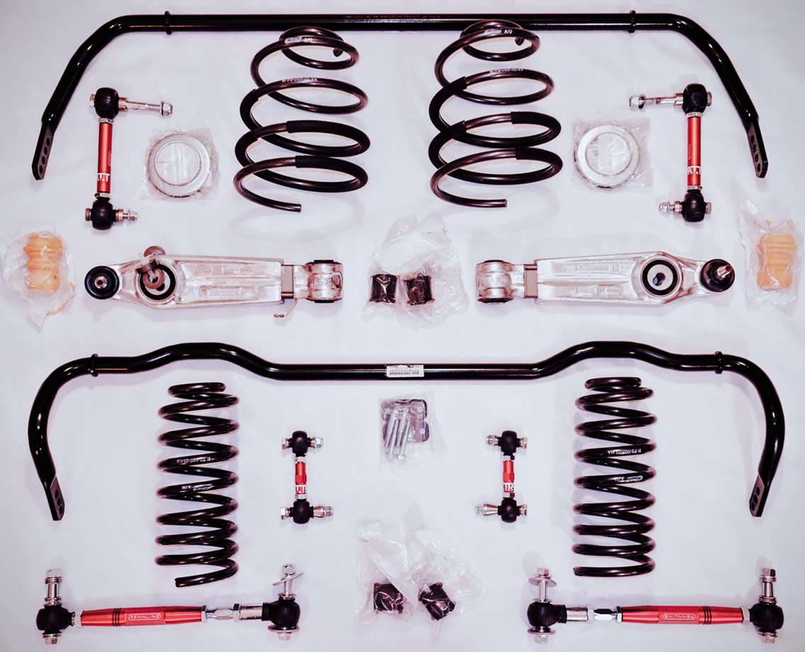

I'm lowering this weekend and installing everything you see here. I'll reply here again with tips and tricks but most of the updates will be on the Rennlist thread I started.

Originally Posted by nwGTS
Attachment 445372
Are these the RSS components from Sharkwerks? Did they put a package together for you? Really interested in hearing your feedback as I've been considering a lot of these items for my GTS.
