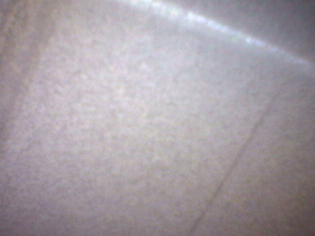

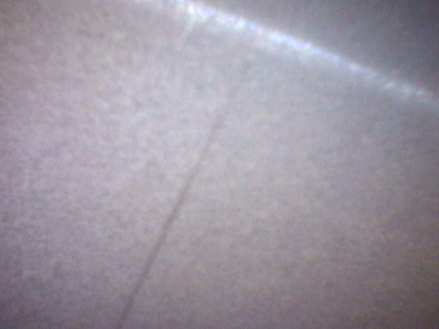

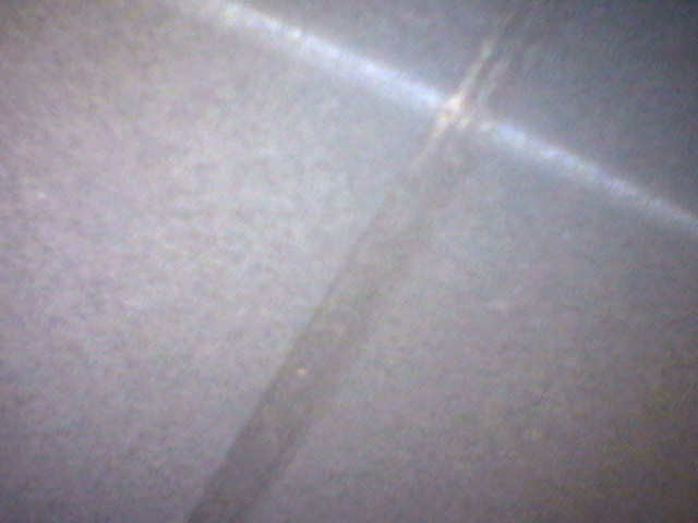

Just bought this 06 C2S with 51k miles AND A WARRANTY!
The warranty is up in October, so I thought I'd have it scoped. #1-5 were perfect. #6 has some scoring seen here:
I don't believe I have any symptoms. No smoking. Oil consumption seems in line (2 bars down on the meter in nearly 3k miles). No ticking like I've heard in known failures (video of mine is here:
). Some noticeable sooting on left tips v. right.
Pics: Name:  DIGI0022_zpsetl1w0zs.jpg
Is this really a "bore scoring problem"? It's just the one line of scoring. Thoughts on what I should do.
