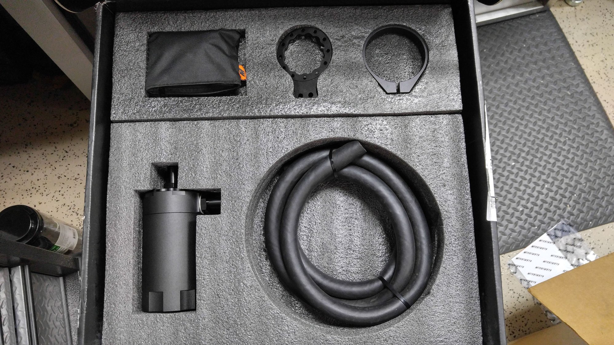

On my Cayenne Turbo S, the crankcase ventilates to the driver's side intake and over time, fills that Intercooler with a significant amount of oil, and by significant, I mean that 1/2 qt or more can be poured out after 25,000 miles. This is common on the Cayenne and not Turbo blow-by as is sometimes the initial, incorrect diagnosis.
Anyway, I mention this because others have installed a Mishimoto catch can with good success and I've just purchased one myself, but haven't installed it yet. They're available on amazon.com and here's are a couple pics of the kit.
