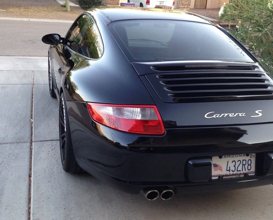

50mm rear offset with 305 tires lowered on H&R sport springs. No rubbing.
Looks good. However, offset by itself doesn't tell the whole story. Need to know wheel width too for an accurate comparison. Maybe you're the same 11" as the PO which is why you didn't mention it.
Yes, 19x11 rear wheels.

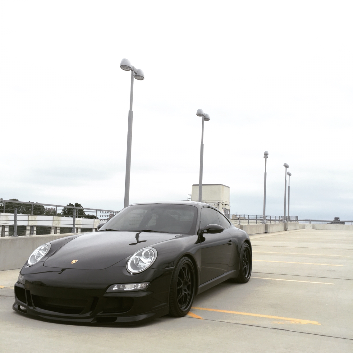

+44 offset made for widebody gt3 running 295 tires no rubbing on kw v3

Originally Posted by sober_owl
Attachment 466539
Wow that front lip is low. Thanks for cleaning the dust off the road for the rest of us - LOL.
That is funny. Too low for roads around here, that won't clear shopping mall speed bump.
