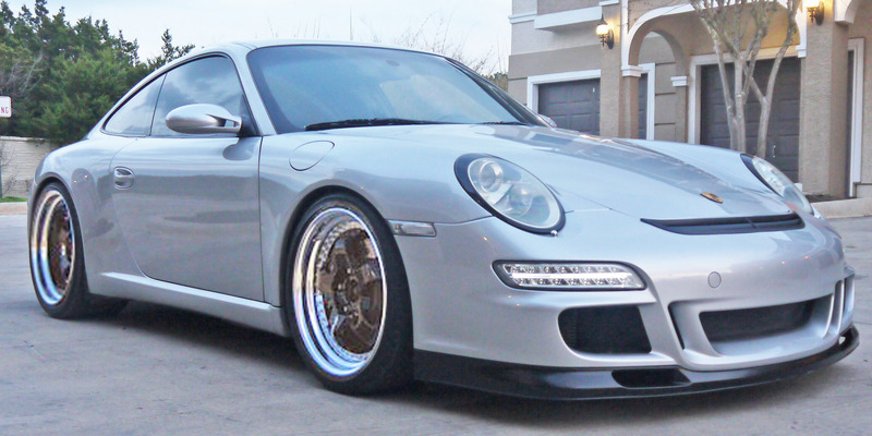

Any know if there are any potential issues with not running a wheel center cap long term on the Work Meister S1 3P wheels? Also, what optimal ET for flush look f/r without rubbing? I'm going to run my near new 295s and assuming 11".
Photoshop

i had this with no rubbing on narrow body
19x8.5 +36 235/35
19x11 +42 305/30
your rears look fine but your front needs way lower offset

Originally Posted by Petza914
Got pics showing the amount of flushness / poke. GT3 wheels are 19x12 ET 68 and are pretty close to perfect. Your setup with the spacer would be equivalent to running a 19x12 ET 50 which is 18mm (3/4") further out. That's like a TT fitment so I'm curious to see what it looks like as it seems like it will be quite a bit beyond flush.
my old set up with no rubbing
19x8.5 +36 235/35
19x11 +42 305/30

Any pics of these setups from a perspective like this?
19x8.5 +36 235/35
19x11 +42 305/30
I just have to say that's an amazing picture and stance! Please let me know what you're lowered on? I'm currently on H&R springs but I'm looking to changing over to coil overs. I ran H&R C/O on my last 997 and KW on my former M3.
