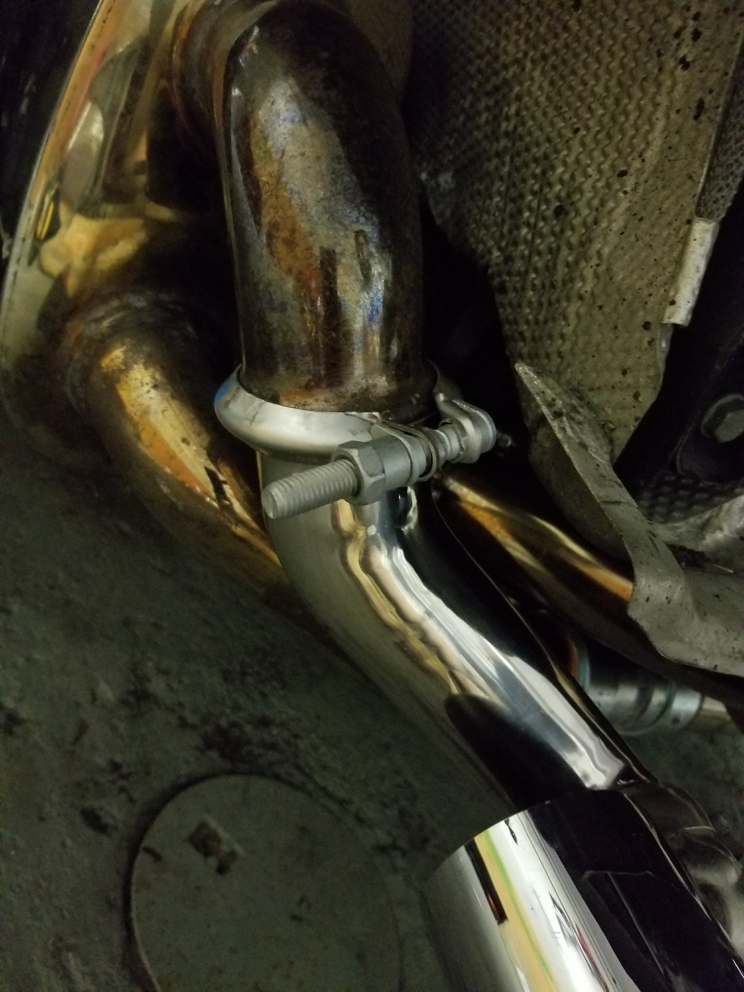

For anyone doing a fabspeed or similar mufflers..save yourself the headache and order this clamps..
10 bucks at pelican..20 bucks for oem...they are from 996 mufflers..after this my tips dont move..and clamps better than vband..

Has anyone found a better bolt to replace these with that is more corrosion resistant?
That silver paint looks like a zinc coating...crc sells them by the can..cold gavalnise zinc prevents rust...that and some antiseized should be enough
