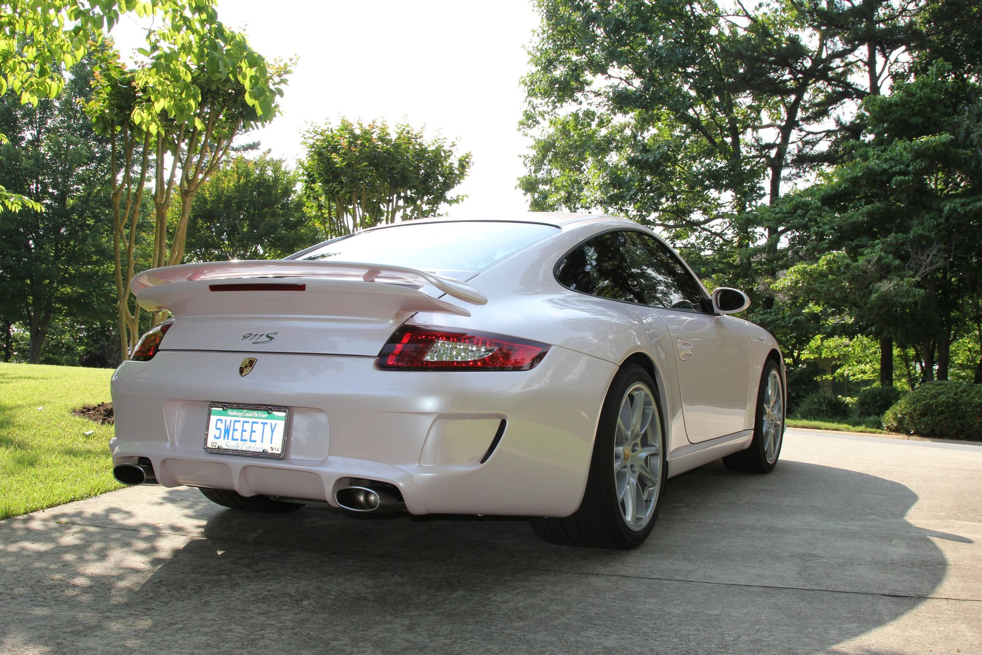

I'm running 305/30 rears on both my 997.1 C2S cars. Wife's runs GT3 wheels
Front - 19" x 8.5" with 53mm offset
Rear - 19" x 12" with 68mm offset

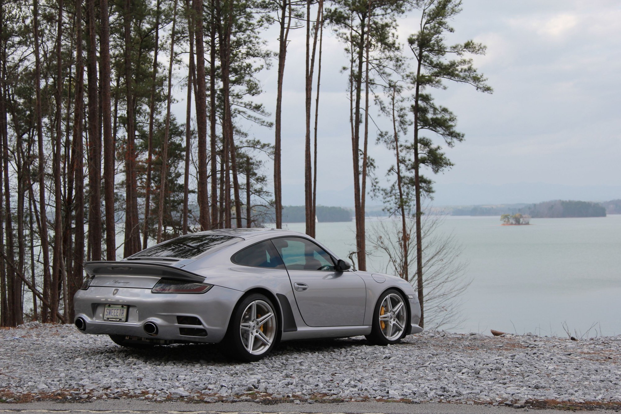

and the stance of her car from a wheel & tire placement to fender was just about perfect. When I ordered my custom Forgeline SC1s, I actually removed the wheels from my car and sent very specific measurements to Forgeline using a digital caliper as I waned them to maximize the concavity of the wheels but also needed to clear the larger 6 piston PCCB calipers in the front. With an 8.5" wide wheel and PCCBs there wasn't a lot they could do there, more so in the rears, but the fitment is perfect. Had to trim a little notch into the inside edges of the GT3 brake duct scoops I'm running in the rears but they're just plastic so no big deal. Wife's car is running Tikore Ti Lug Bolts and I have World Motorsports Ti Lug Nuts. My car has a stud kit installed and the rears were a little longer because of the RUF wheels with spacer that were originally installed, so I customized the normally closed end lug nuts to knock the center out to get a proper fit of the nut seat into the wheel, but still leave the shoulder of the lug not to cover the threads for aesthetics.
I tweaked the GT3 offset #s a little to get them exactly how I wanted since the Forgelines are fully custom forged and they are
Front - 19" x 8.5" et 50mm
Rear - 19" x 12" et 74mm
so the outer edges of the wheels have the Fronts 3mm further out than hers and rears 6mm further in. I came up with these #s based on how the previous 4 sets of wheels I had on this car fit, plus the measurements from the Forgeline worksheet I submitted to them, which looks like this.

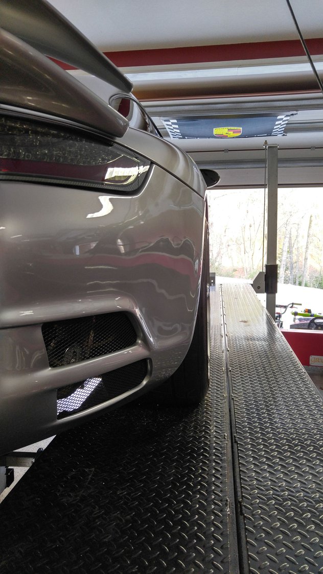

I have factory 305's on my 4S and they are on 19x11 wheels. I run 20mm spacers in the rear and that should be equivalent to your 19x12 wheels. I have not issues with rubbing. My car has the factory PASM sports suspension. The sport mode is to harsh for me now. Can only use it now and then. Getting fcking old.

I have factory 911 19x11 wheels and factory 305’s. Running 20mm spacers. The 305’s will stretch even more on the 19x12’s for even better clearance.

Porsche sold me this setup as standard equipment. On 997.1 Targa 4 and Targa 4S the 305 on 19x11 is the factory standard.
Porsche is pretty good at what they do so I’m good with that setup. Just surprised I was able to add 20mm rear spacers and still have it tucked in as in my picture.
